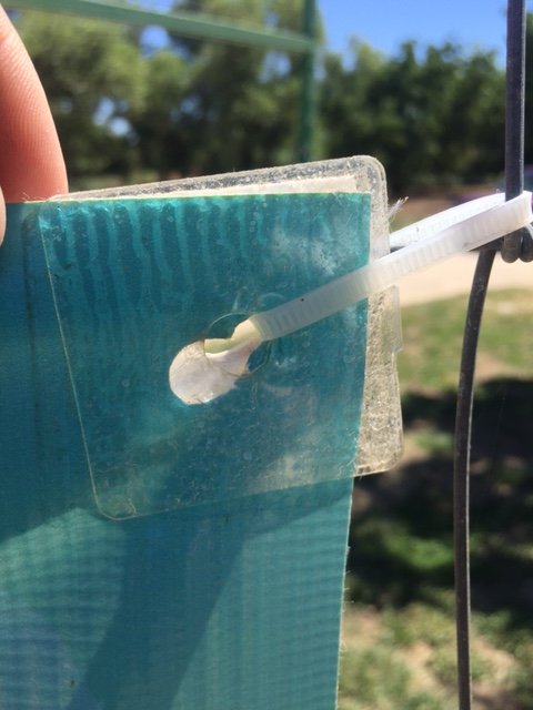

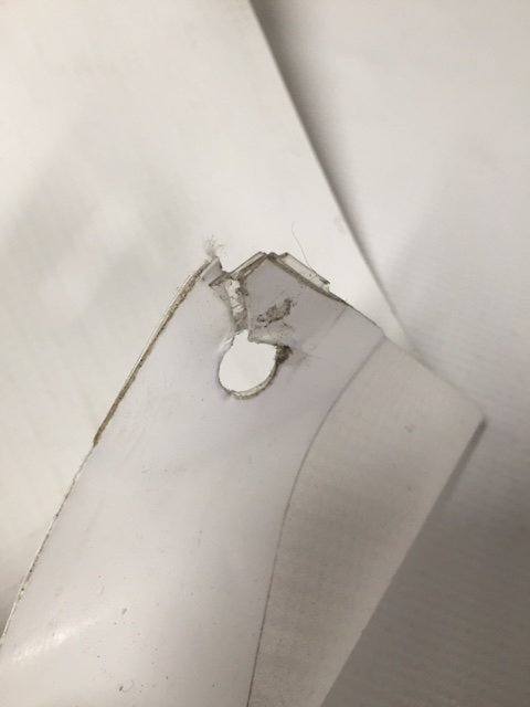

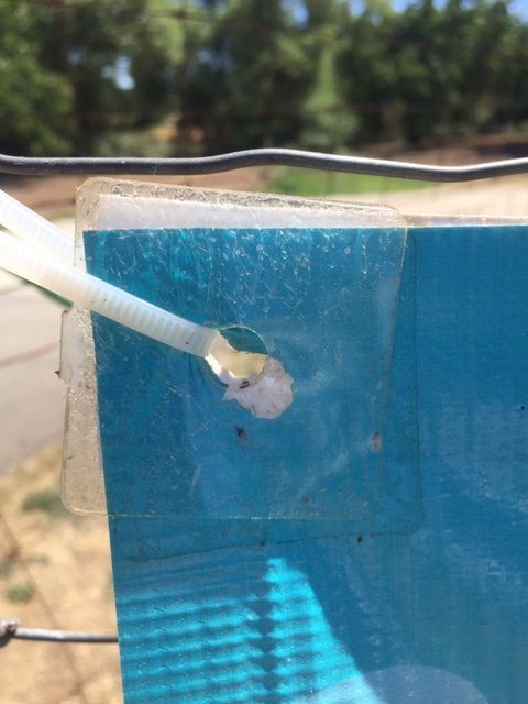

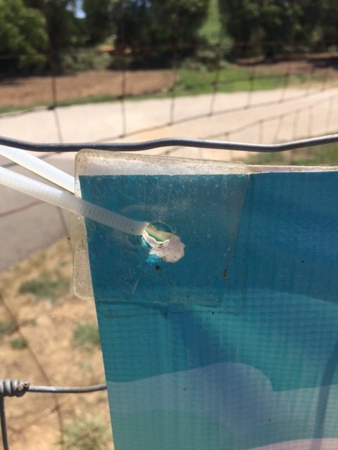

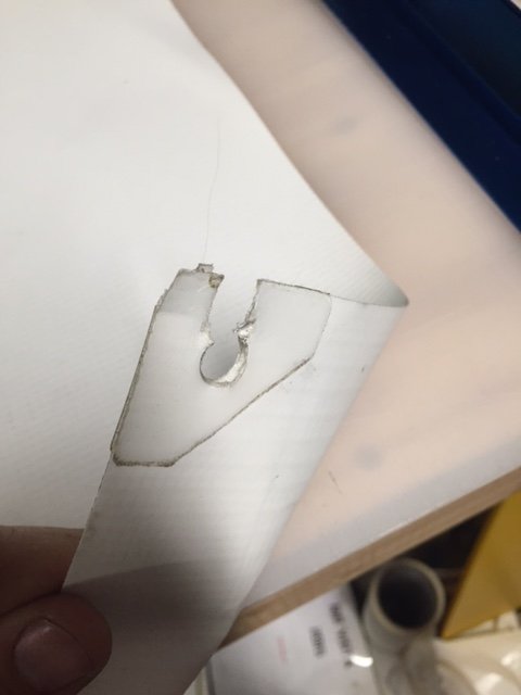

While seeking new, better, faster methods of hemming banners i decided to try Bannerups. I searched the forum and did not find much info good or bad about them so i ordered and tried them out. I have used them on several banners now and they are failing after less 4-6 weeks. One banner is 2 x 5 with mini power tabs (4 corners) bravo tabs top and bottom center, and power tape (i know the mini tabs are for light duty outdoor). The other banner is 2 x 7 with Bravo tabs (5 tabs top and 5 tabs bottom) and power tape. Here are the photos, judge for your self. Site info: Winds have been minimal since installation, both are on fences, both face east, both were zip tied. Banner Material: both Arlon DPF 313 13 ounce. Not looking to bash the product, just want to tell about my experience with them.

What's the temperature where they are hanging? If I had to guess, I'd say the adhesive in the tabs is "melting" due to excessive heat. I'd guess that if the sun were hot, the tabs would definitely slip if the adhesive softened up. That's what it looks like in a couple pics. A grommet supporting it would help prevent that for sure.

Mid to high 90's. i will add grommets to all of them until i get rid of the rest or use for indoors. As someone previously stated, they dont work as advertised. Disappointed no one from bannerups has responded, oh well, chalk it up to a lesson learned.
