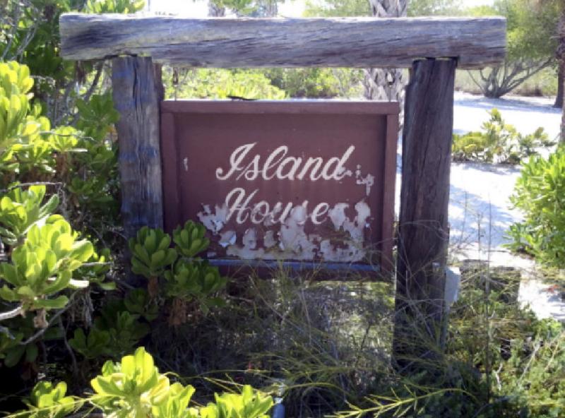

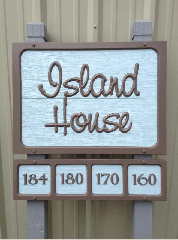

Made this very simple dimensional sign for a group of homeowners to replace an older wood sign that was falling apart, made by someone else.
Sign is all PVC and the posts are pressure treated 4"x4"'s. I sandblasted the posst after notching the tops to give them a driftwood look with the raised grain. Sign was pretty small, 30" x 30"

Too modern and cheap for me... would have been nice with just the sign within the old posts. The new one screams "cheap... tacky"... old one screams "permanence.... here a long time"... which do the multimillioniare homeowners want... probably the "permanence"... weeds and shrubbery def. needed to be cleaned up around the old sign though. Font on new sign is more "preppy kiddy" rather than just a simple, clean, permanent font. I wouldn't have sold this to the customer.

Looks good to me! Did you prism rout the copy then apply it to the woodgrain, or was that done all at once?

There budget was limited to $1,000.00 and they insisted it last. Between a rock I guess. Hard as I tried to sway them, (committee apparently) they insisted on this version. I just could not sway them. They must be ultra preppy huh? Didn't want to spend the money to get their grass mowed either.
Sorry letterman, in answer to your question. I made the letters separate and then applied to the background. It's faster that way when it comes to finishing.

Really like it bob. Are the letters pocketed in or surface applied? And what glue do you find works best? Great work.
John the letters are pocketed. This way I don't have to worry about my guys screwing up the spacing. Light weight letters, GE Silicone II with 1/8" holes in the back of the letter and the hog out area. The silicone ooozes, (sign terminology) into the holes for added holding power. On larger letters, I use 3/16" aluminum studs for peace of mind.

Quote it high and stick it in the old frame... maybe stain the old posts if they think they're too "old".
I might mow lawns but I'm smart enough to realize that the old sign shouldn't have been entirely replaced with a cheap version on 4x4 posts...!
People don't realize what they're getting... "newer" is NOT better...
Question to the OP... did you try to sell them something in the old sign frame? Maybe there's some context to the area that I don't know about that warranted putting in new posts... relocating the sign for instance.

Not a huge fan of the design either, It's too slick, and the colors a little drab. I definitely would have tried to sell them on more natural materials. Sure, it won't last 1000 years, but many beach houses have that comfortable, weathered, lived in look anyway.
Execution is great though.
