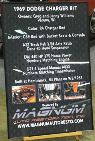

Sorry for the delay in getting back on this.
I have to remake a few of these boards, They are claimed to be a solid pvc board with a black border that is installed after the board is printed. They do not have a foam core or any other type of core.
Would love to find these boards with the border with them.
Anyone have any ideas on where to get these.
