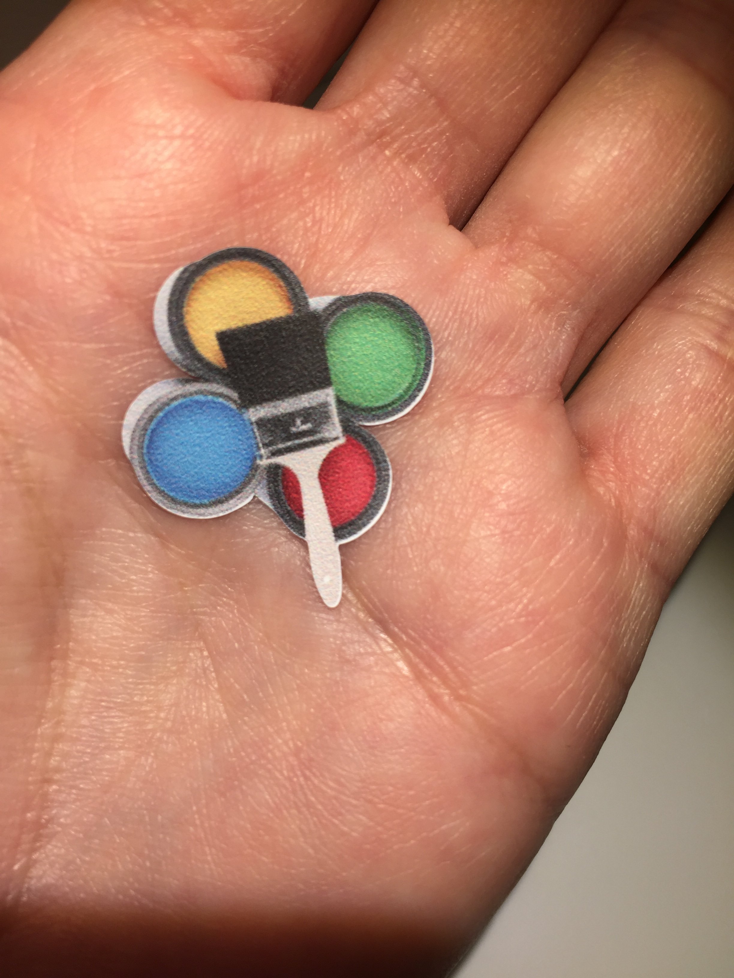

Can't see since they dont super zoom in, but it doesn't look bad to me.

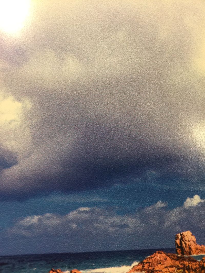

I attached a few pictures, the first is on Roland Glossy from a test file the tech printed. The second is on the 3M IJ36-20 with my images. I've tried vector and BMP.
The tech has been here for 12+ hours already, I've spent hours trying to change media profile, color profile, heat, uni print versus bi-directional, etc. No calibration issues.
I am using the 3M IJ36-20 and this is the material I want to sell in my store.

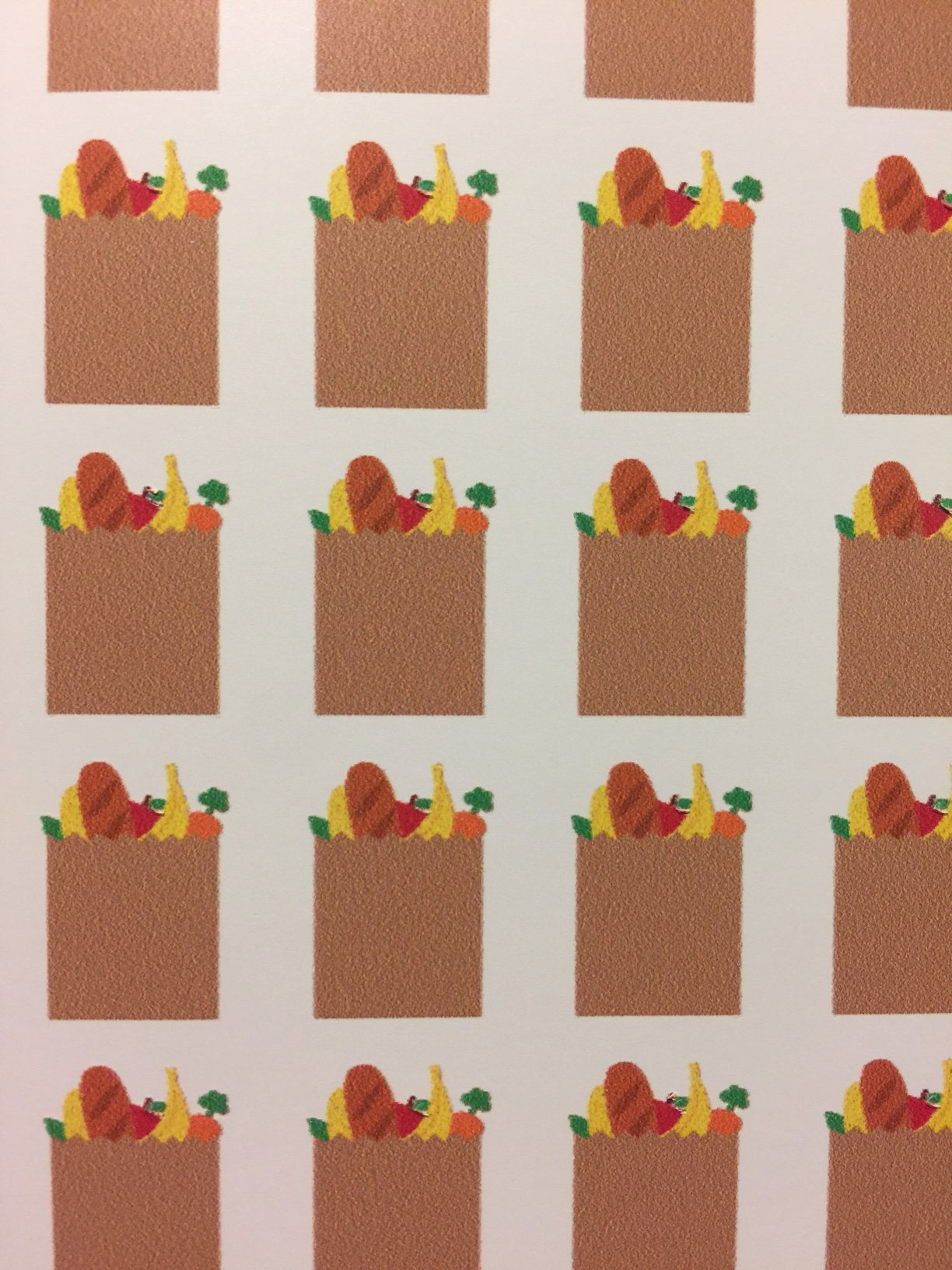

The sample print you attached looks great to me! I don't really see the fuzz. Here is another example for you, this is a close up of this image on glossy vinyl. From far away this looks really nice. Close up, not so much.
I wish I had all day to troubleshoot this machine but I don't, I have a business to run. For the money I paid for this, it should be blowing me away with the image quality out of the box.

Yeah, something definitely looks wrong with your printer. It looks almost as if your printing on media thats already rugged (never used IJ36, but I'm presuming from my search its not).

I don't think that you'll get anything better than what you are looking at with the Roland. What I see had nothing to do with the stock or passes but the actual picoliter size of the ink drops that the Roland it putting out. It simply cannot "squirt" a smaller ink droplet than what you are seeing.
I have an HP L26500 and get beautiful non grainy prints off it on just about any vinyl.
Be aware too that the lighter the color that you are printing the more obvious the droplets well be as it takes far less of them to print a pastel shade.
