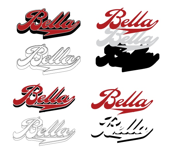

I did this in Illustrator... Corel can do it too, the problem with Corel and Illustrator is that slight distortions can happen when extruding your drop shadow, I deal with it by adding outlines to hide some of it.
If you are doing drop shadows on a daily basis, Flexi makes sense, as mentioned before, it rocks with drop shadow, if it's only occasionally (once every few weeks) then go with the few extra steps in Corel...

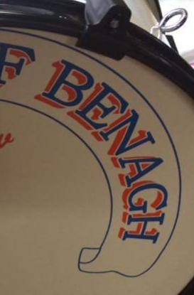

This is the graphic idea I would like to learn
In Corel I'd duplicate the text three times and distribute them offset accordingly then use the middle one to trim the bottom. Select the middle then shift select the bottom and choose trim on the top menu then go back and delete the middle one
I tried this method and seems to work . Quick and easy. As I'm still trying to figure out the whole design thing (self teaching by just clicking buttons .) I'll use this way until I find a better or purpose tool to do it.. Thanks was great help
