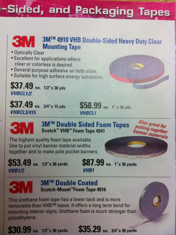

Would you recomend the top one, or the one below it?

Si Allen
Unless you have two perfectly smooth surfaces ... use the VHB foam tape.
It will compensate for any irregularities.
3M VHB Foam Tape it is. I'm excited to use the stuff.

That was one of them. I could not believe they used this stuff on skyscrapers to install pannels.
I have the 4941 but I think the 4910 would be pleanty.
