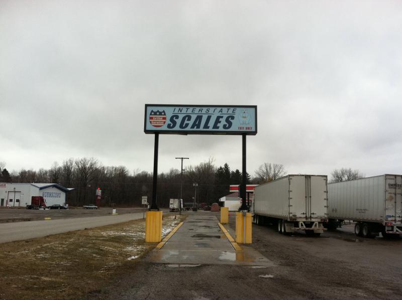

Quoting this job right now for 2 polycarb translucent faces. Approximate size of the face is 5' x 18'. How would one go about installing these?
I am thinking I will need 2 bucket trucks because the faces are so long. Any input would be appreciated!

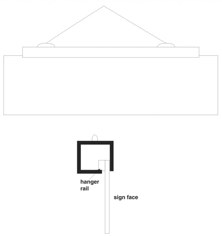

we have a metal "thing" that was built (it was at the shop from before I came here 10 years ago so I have no idea of it's origin) that will hold a sign face that has a hanger rail that you can then use a bucket to lift it...usually need a guy on a ladder up against the sign to pull the face in

Thanks for the replies. The bottom of the sign is easily 15'. I am just not sure that a single person on a ladder and one guy in a bucket can keep control of this thing if a large gust of wind comes through (happens frequently right on Lake Michigan). 18' long is a pretty large sign face to hold on to. I am still leaning towards having 2 buckets at this point.
I might be going overkill but actually I had a mishap on a ladder a couple of weeks ago taking down a sign by myself when a gust of wind caught it. I fell from about 10' and landed on my foot (miraculously not my head) and hurt it pretty bad. I've been limping around for 2 weeks and thinking about all the different ways this particular install could go bad having me thinking I would feel much safer having two people in buckets.
If there were only one bucket, how could one guy hold on to this panel if it doesn't have a hanger bar?

Please forgive me, (I'm probably opening up a can of worms and won't be able to show my face around here for a while) I'm not sure how much experience you have with larger lighted signs but and don't know if you've gotten up there and taken a good look, since you said approx. on the sizes... Just a sneaking suspicion here, are you sure those are poly faces and not flex faces? They can be deceiving. The photo isn't great but those retainers say flex-face to me. Please excuse me if you already know. Now, yes definitely 2 buckets or crane and bucket. Have used two c-clamps and straps to raise with, awful long face maybe two angles, one on each side with c-clamps pinching the face between them and straps to crane. Good luck.

You are right in the fact that I have not actually went up and checked them out, but I am 99.9% sure they are not flex faces. From below the sign I can see a little space between the retainer and the face in a couple of places, but I will be checking it out up close tomorrow. I have installed plenty of lighted sign faces, and a couple of fairly large ones, but 18' long by 5' high kind of makes me second guess myself, it is pretty huge by my standards.
