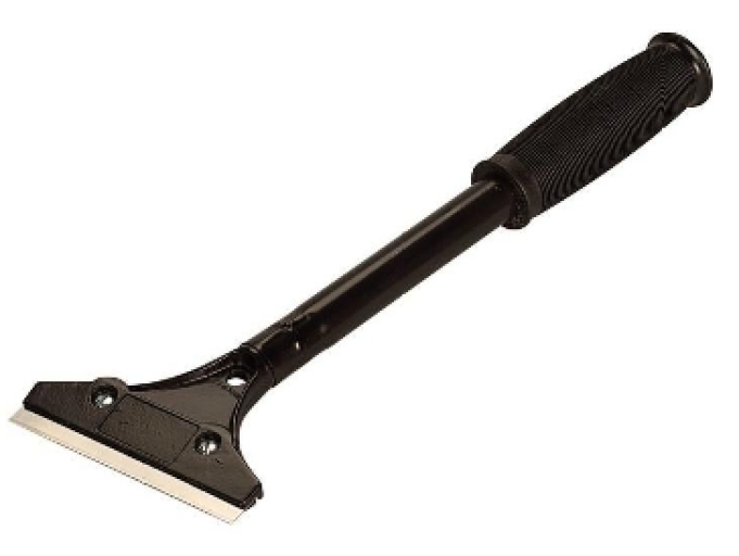

Get one of these scrapers and use either Rapid remover or glass cleaner to keep the glass lubricated so as not to scratch!
this is what we do, with rapid remover... or screen cleaner. believe it or not, rhino screen cleaner works better, faster, with less of the spray.
