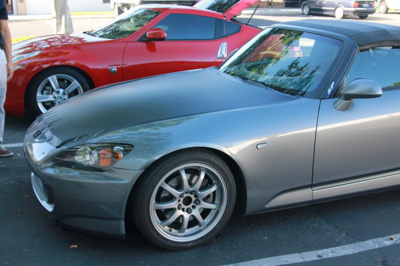

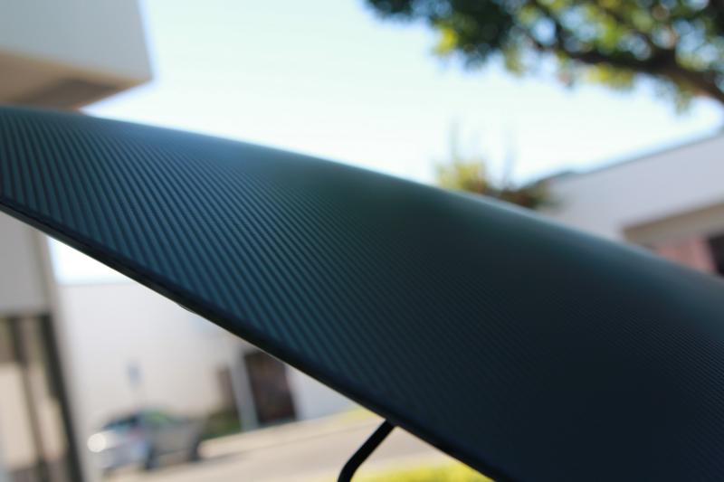

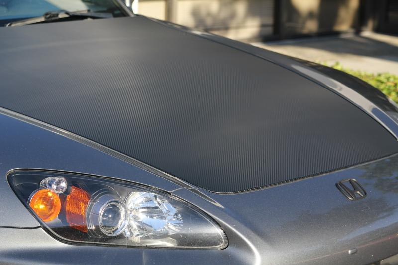

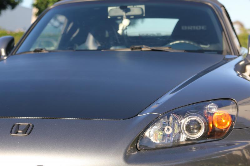

It was done by two first timers. It was rather easy. After the wrap, he ordered one roll of black CF material.
Baby shampoo + water
Two squeeges
Two office cutter
We used two hours.

Loos good but it doesn't have air agress?
What's the pricing on a roll or yard?
premiercolour
Merchant Member
It does have air releases. We are testing the water, asking local sign shops to test. So far they love the material. Will keep you & signs101 posted.
