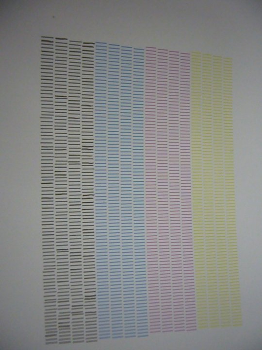

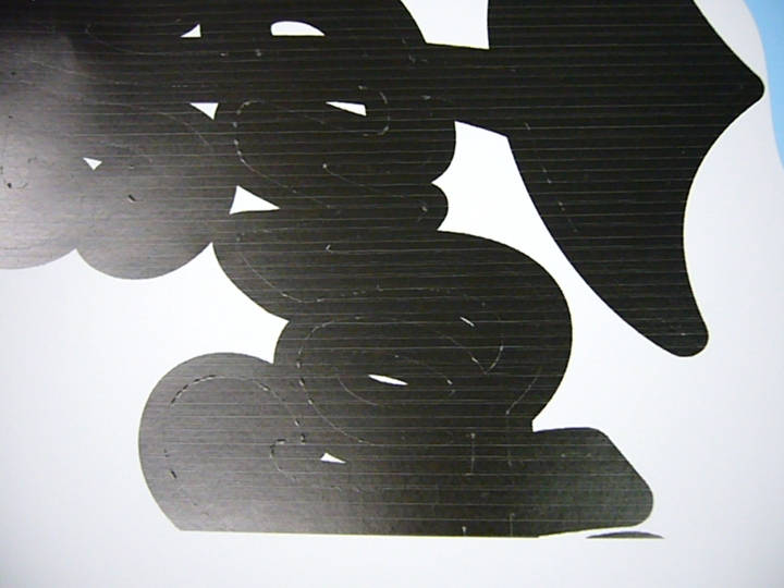

I just noticed the pics did not upload. Here they are again.
There is a recent print test after several cleanings, a print of black on a smooth vinyl ( comes out so striped it looks corrugated ) and then a regular black text print.
Jester1167
On the small text it's all those deflected nozzels on your black head. Too many head strikes. Some of them may come back with a heavy cleaning or over time. Better start saving for a new one.
The print cut black looks like banding and you need to adjust the feed. It could be the nozzle deflections too or a combonation of both.
johnnyrod
I checked the feed, but only the black gives that problem. None of the other colors do that banding when printing side by side. I tried adjusting the printer feed, but there are so many dropouts I can't even see where the gap is in the figure. I can try to adjust the bidirectional and see if it's got a better setting that I'm not aware of.

I doubt those deflections are from fibers or dry ink. More than likely they are damage from head strikes. That's why you better start saving for a new head. It's about a grand for a tech to replace and align a new head.

Your black head is scratched...no amount of cleaning will improve a scratched head. Replace the head ($995) - scratched heads are not covered by Roland Warranty. Have your technician perform the head replacement and a full service and your printer will be printing like new for a long time.

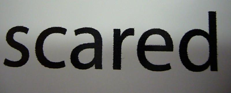

that pattern around the word "scared" is odd. using a loop. does it look like printed dots or are they elongated or washed/dotgained together?

That's not your problem though. Your black head is FULL of nozzle deflections. It's simply not laying the dots down where it's supposed to. That's why you're seeing the little random dots around the text. If the solid color you're printing with the black text on top has ANY black in it it will look worse compared to printing on white because it's laying down more black dots.
It's causing the misplaced dots, the lines, everything. Try the head soak recommendations that were posted up. It's the only hope you have of any improvement without replacing the heads. Your black head might not scratched, but it definitely has issues.
