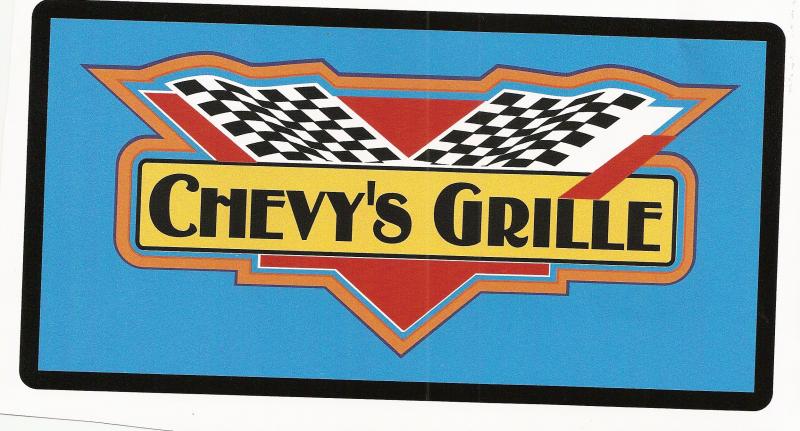

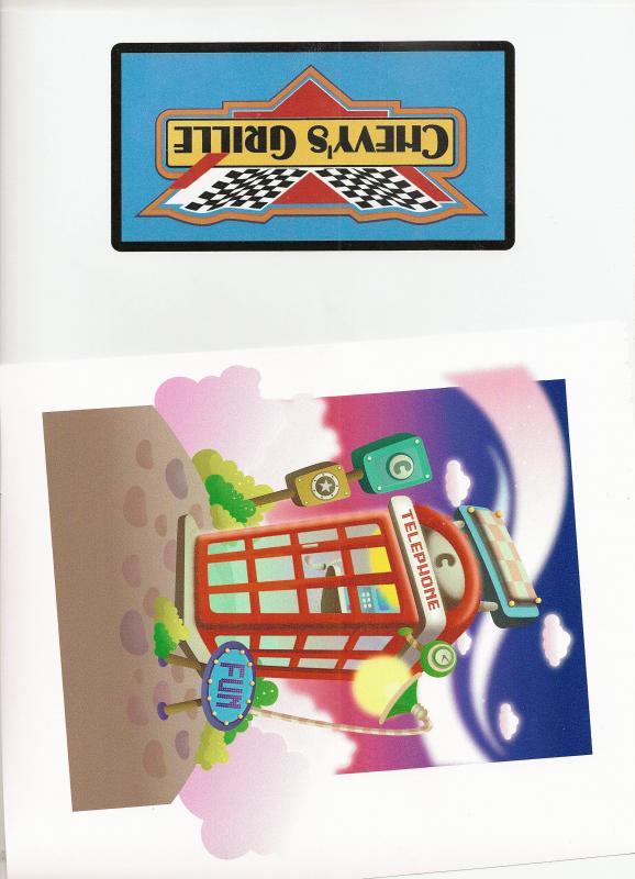

I purchased a SP-300v about a month ago and my prints look blurry.
This is a used machine but i still have warranty on it.
It doesn’t matter what media ,profile or quality I print on it has the same result.
We did replace the BK/CY print head but didn’t help any.
I'm new to the digital world and it is very frustrating .
I'm not sure what I'm doing wrong.
Can't see much on your images. Blurry printing can be caused by several things, including printheads that are not calibrated/ aligned, dirty/ scratched encoder strip or sensor, or nozzle problems (deflections).

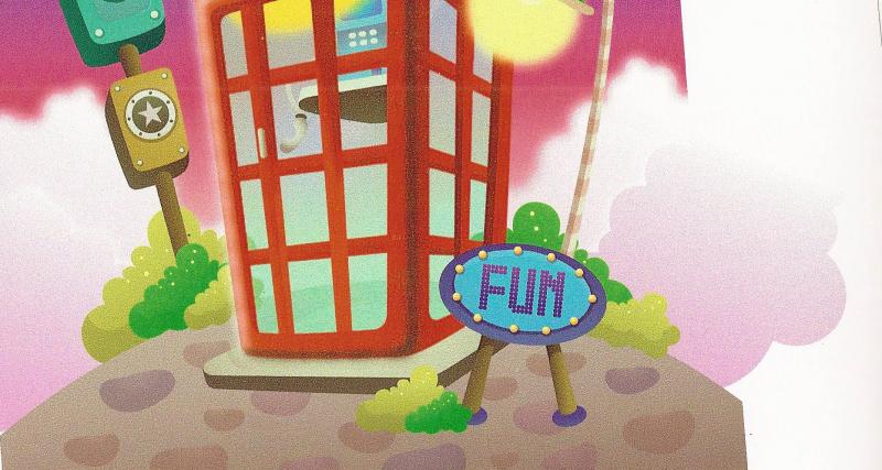

maybe this closeup is a better picture.
slangsc

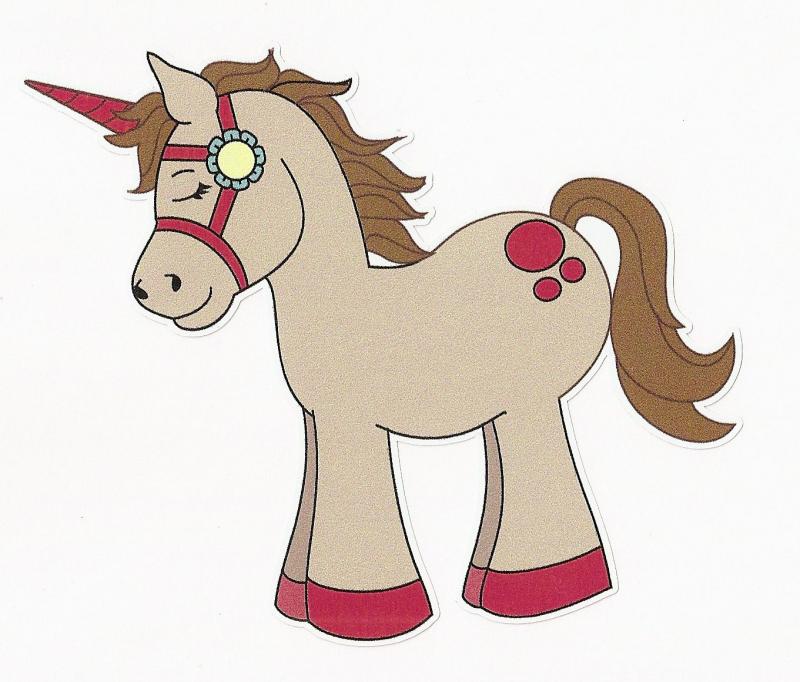

I think what you are seeing is the resolution of the printer - the physical dots. What setting are you printing with? Looks like some kind of low res print setting.
eaddesigns
the horse was done on standard quality (720x720) and the sign was done on high quality (1080x1080)

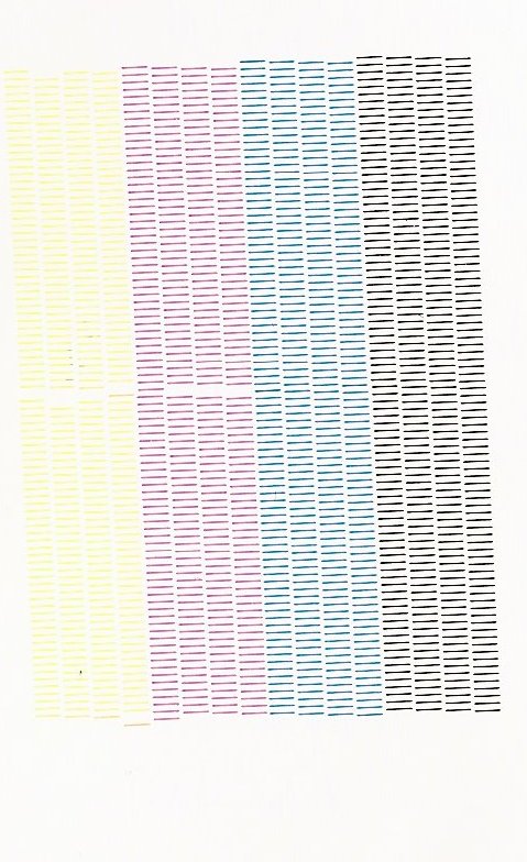

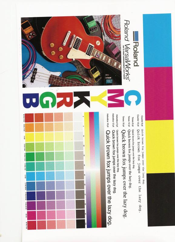

this is a test print from versaworks on high quality and the one from the printer

After looking at the test prints... it appears to have something to do with the quality of the information you are sending to the rip.
There's an old saying... 'Garbage in... Garbage out.
I believe you need to work on your skills a little there. The 300 is capable of better output and your test print proves that.
