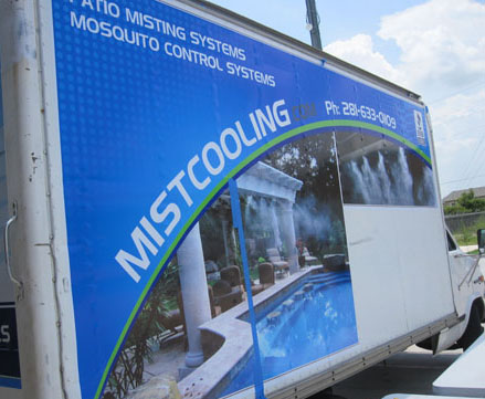

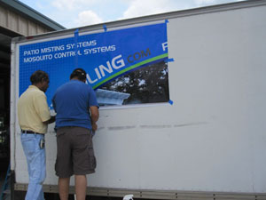

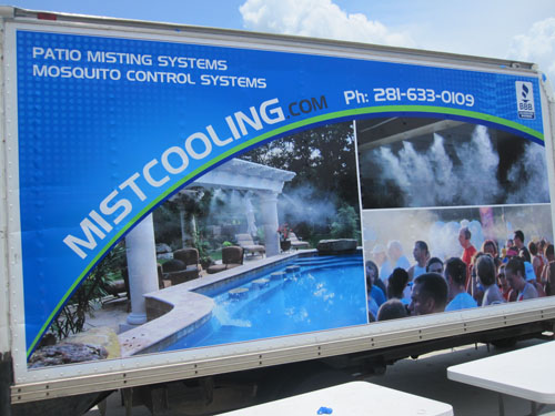

Good News, just finished the whole truck,
See the pictures..
The 2nd side of the truck started at 11am and finished at 1.05pm finished in just 2.00 hrs
Not bad for the first time installer, and very economical way too, with new innovative techniques that will help new installers who want to start their career.
The whole project cost is just under $ 1000 with all four sides..

What why would you do that? Choose one seam path either vertical or horizontal and stick with it....
Also how come your graphics don't go all the way to the edge of the aluminum panels?
I'm not trying to knock you we all started somewhere, just have legitimate questions.

Oh my.................
Nice job i guess for your first try.
In the future, if you're going to do horizontal seams...Always do the bottom first.. that way your overlap isn't facing up, for rain, and dirt to slide into.
2nd.. Never print like that.. Why not just vertical panels from top to bottom, would have been 10 times easier.
1k? no offence, but you won't be in business for long doing it that cheap.. unless you're using crap vinyl.

Not knocking your work but proclaiming to help new installers with innovative techniques when you should be applying the bottom panels first really takes away from the guys who have been doing this a lot longer.
The last thing the industry needs added are people giving advice and techniques that are incorrect.
Did you post heat around the rivets? If so what temperature? Why type of vinyl are you using (not the brand)?

You are playing to a tough crowd here so lets see some close ups of the finished seams and rivets. Details make or break the install.

Post #3, dont cut it and start at the bottom. Did you think we were Crazy? If you not going to take advice, dont ask for it. Since you put the wrap on upside down, at least seal the edges.
Scott
one way to protect the backwards seams is clear spray urethane... dries 100% clear and will prevent build up on/in the upside-down seams
Also you rivets in the last picture look like they are starting to tent. Since you look to be using calendered vinyl I recommend getting a rivet roller and cutter. Use the roller to press the rivets completely down and use the rivet cutter to cut perfectly around the rivet head. This will prevent failure due to the rivet heads and IMHO make the wrap look much better than with tented rivets.

Looks like the rivets aren't even tended too, Unless it's the way the photo looks
