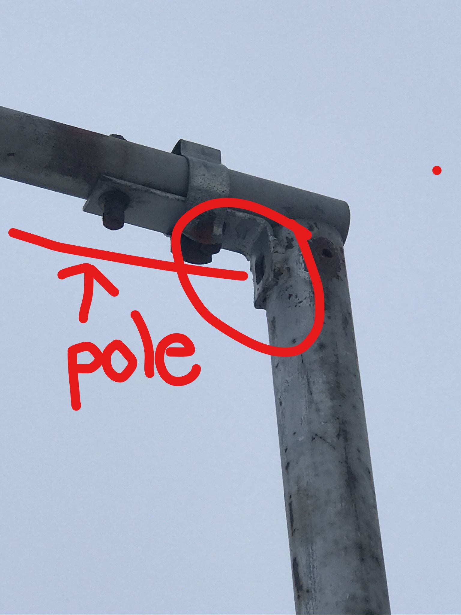

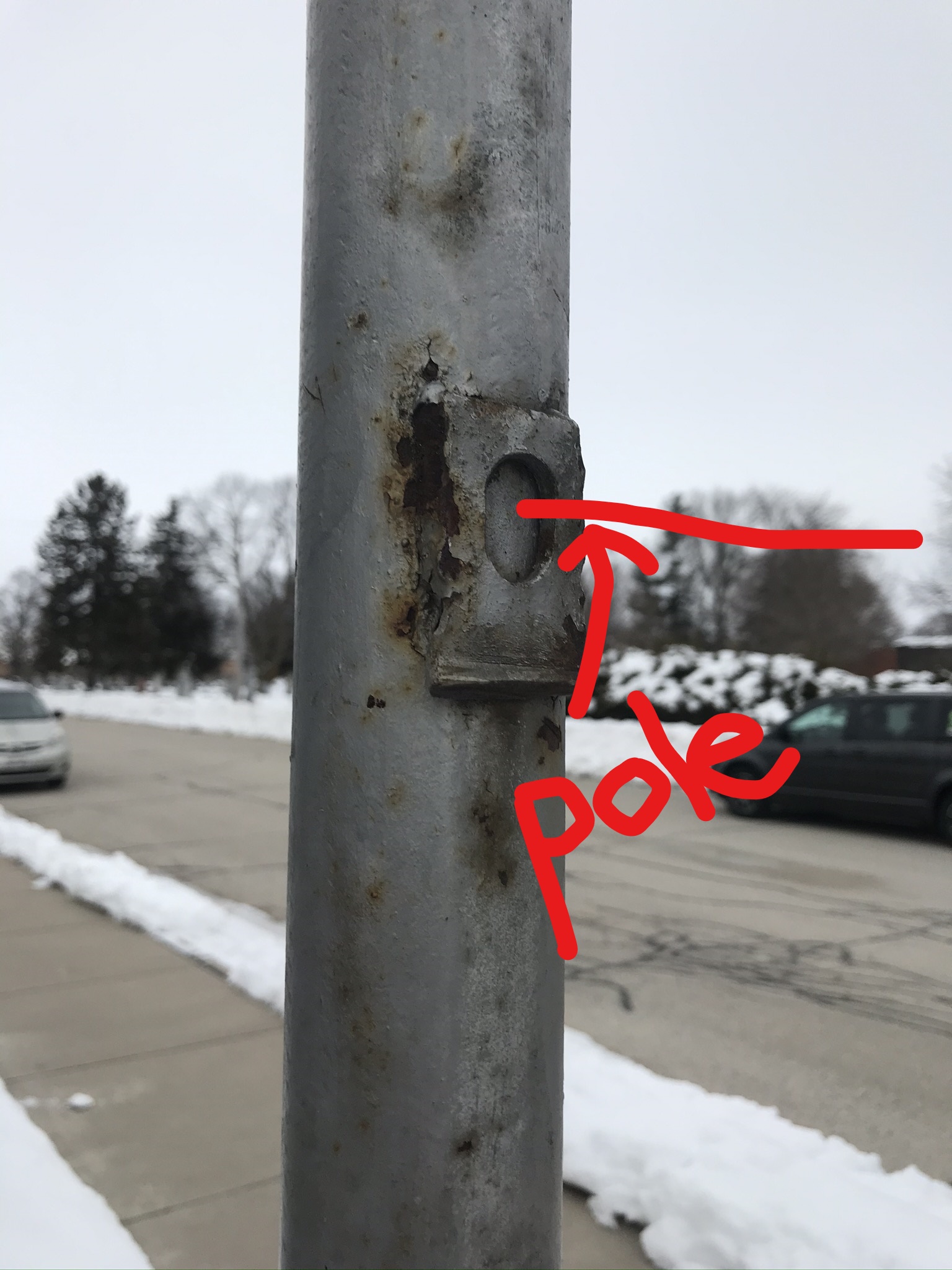

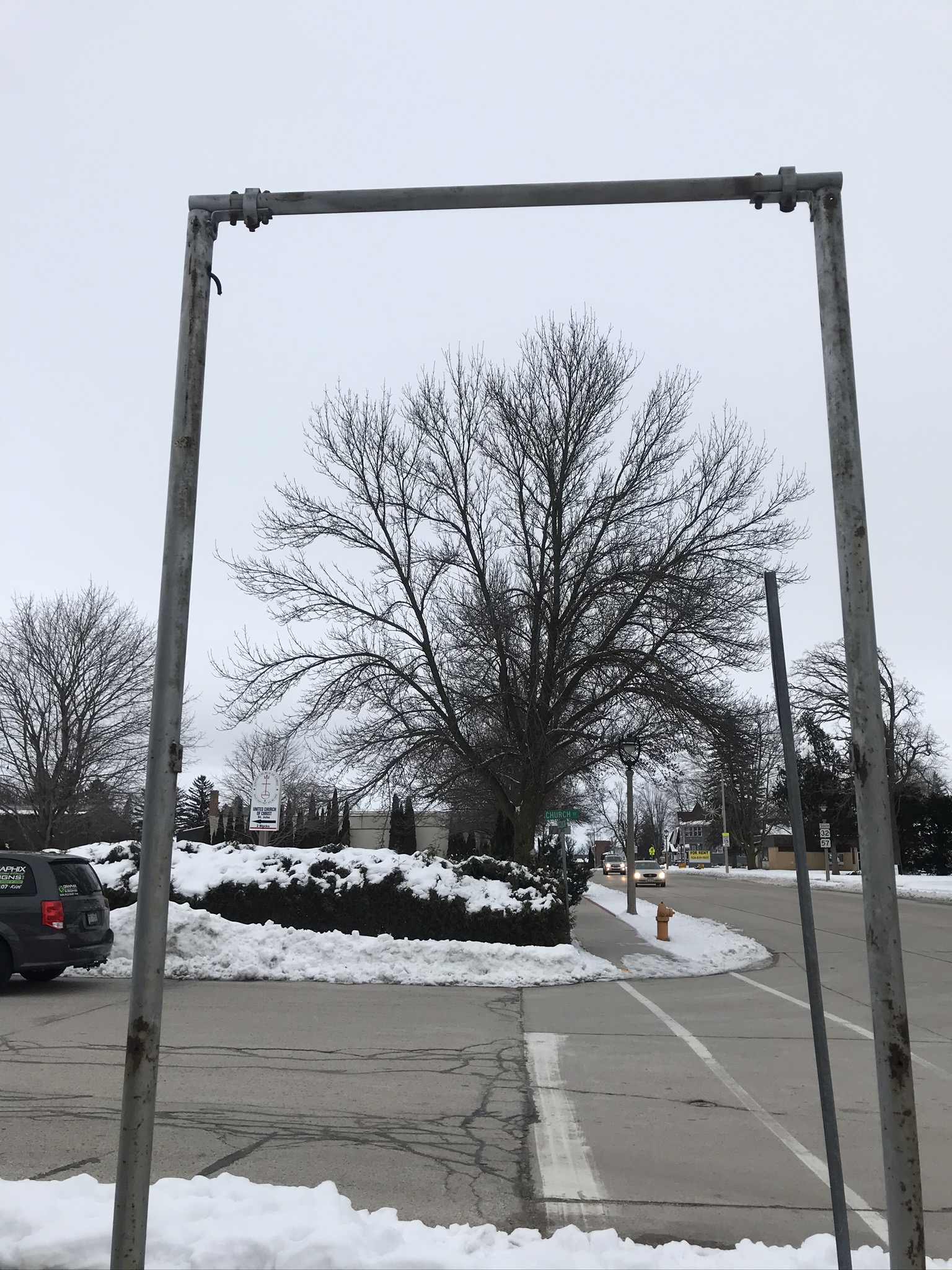

Disclaimer...I don't do a ton of installations. If the customer installs, we go over the best installation techniques...no issues or disagreements so far. Went out for an estimate last night and the husband suggested aluminum with zip ties. Obviously this is NOT going to work. However, I'm not sure what the best idea is here. Size is approximately 48"x48". The old sign had poles that went across holding the sign in but how would I get them in? Steel poles won't bend. I'm slightly confused about this. Since they suggested zip ties, I'm guessing they don't want to spend a lot of money on fancy brackets. Thanks!

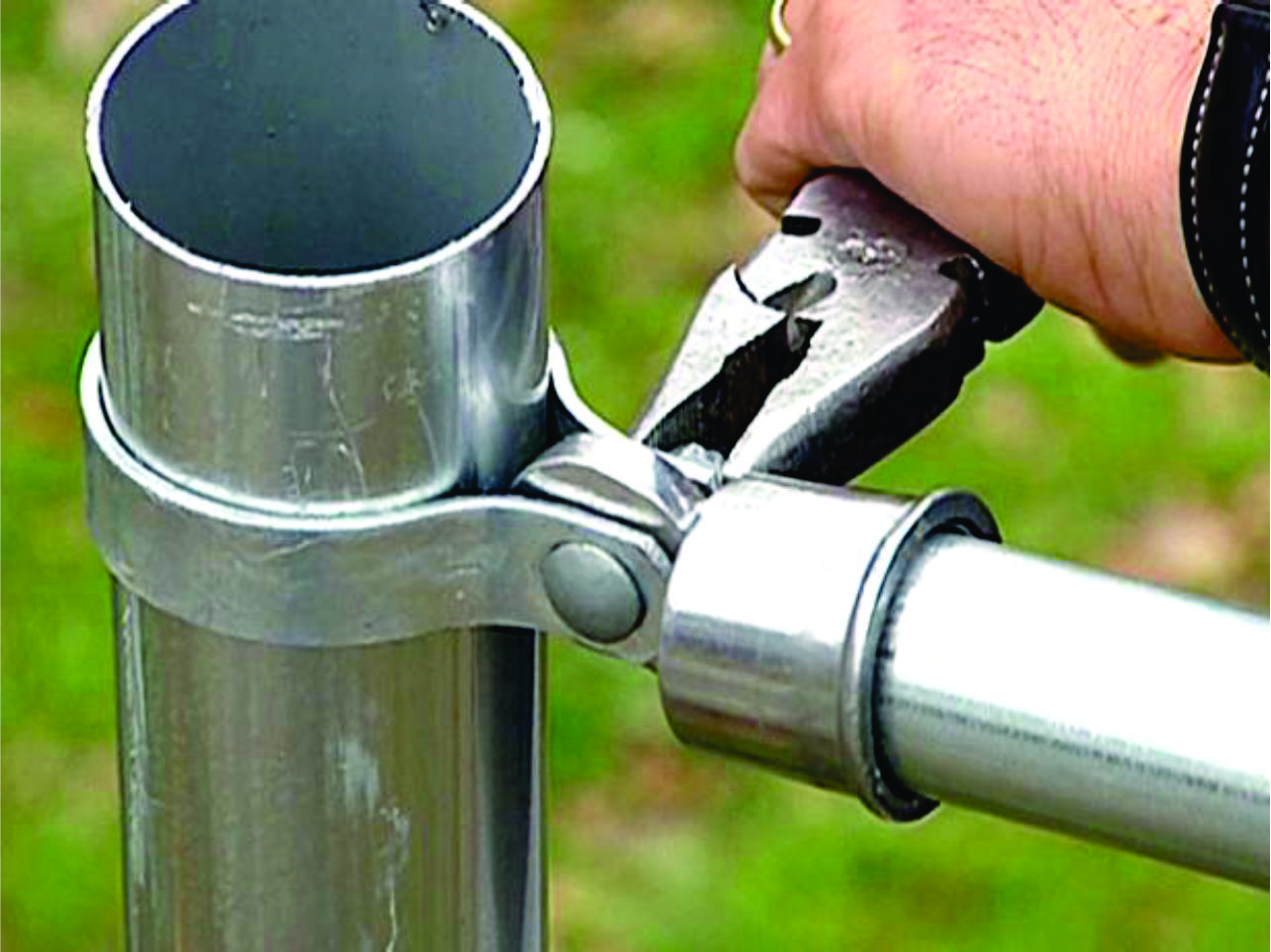

As has been said, it could be done as a hanging sign, for which I would use 3/4" MDO and sign hangers.
Or you could use fence components like Texas suggested and use 6mm ACM. see pic. In that case I would do 2 or 3 on top and a couple on each side. It looks like they used that type of hanger on the top

LOL! I was just looking at a similar pic on Home Depots site! I think this will be the easiest way to go for this customer. I prefer the hanging sign but not sure of the skill level, will provide both suggestions. Thank you everyone!
