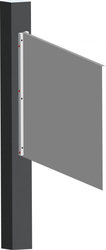

I've been thinking about it more. Do you think this will work (see attached)?. I would use .125 aluminum, attach it into the edges of the PVC with several screws (countersunk) and then attach the aluminum/sign to the post. My main concern would be the connection between the aluminum and the pvc. Will it be durable?

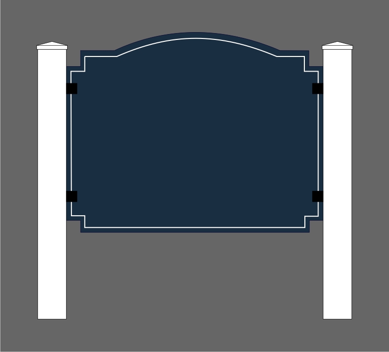

I would use the brackets that are much like those but are open on both ends instead of being a cup. I'd paint them matte black and would mount them on the sides of the sign about 3 or 4 inches down from the shaped part, two per side. by doing that, the hardware becomes part of the overall look and not just something to hold the sign up
Here's what it would look like using Marlene's suggestion. I hadn't considered making it "part of the overall look" and if you all think my other idea is not durable enough, this is probably what I would go with.
CES020-I've seen(and used) the same method you mentioned. For this sign, I only have 1/2" between the edge of the sign and the border so it would be tough to make work for this particular design.
I use this method on thicker signs (sandblasted, ~1.25"+ thick) but would be worried about the screw holding in 1/2" material
You probably picked up the 1/2" measurement regarding the distance from the edge of the sign to the border. We're actually using 3/4" Komacel. Would you still be worried about the screws holding knowing now that it's 3/4"?
Marlene
yep, that's what I had in mind. I like to use exposed hardware like this as part of the overall look
That is a perfectly good method. The connection between the aluminum and the PVC is of no concern. The aluminum should be a minimum of .125 or maybe a little heavier. You do not need 6 screws to attach the aluminum to the post, only 2 are needed, one at the top and one at the bottom.
