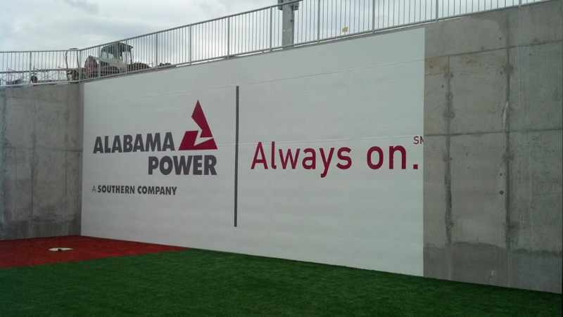

I second the 3M 480cv3 for textured wall applications. We just did a 90'x13' concrete wall with it, printing with solvent, and it worked great!
Here's part of it as it went up.

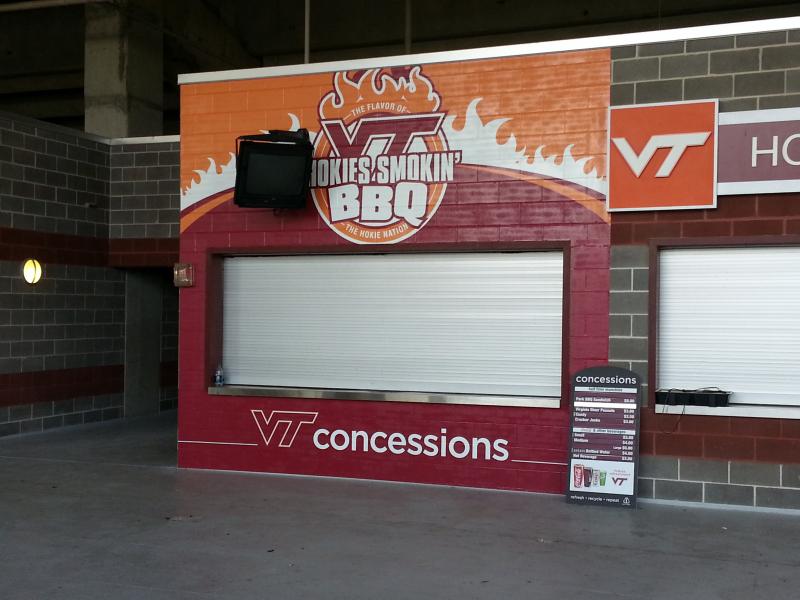

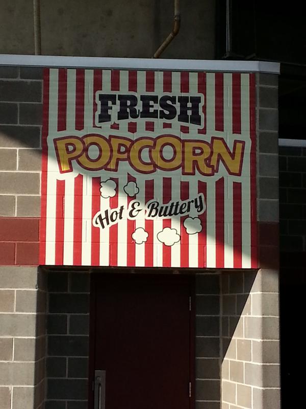

Just wanted to give an update of a job I did that was for a few wall prints about a month back. I used 3m 480cv3 and it worked great once again.

Here is a time lapse video of this install we did back in April in anyone is interested. We did this for project for our Town and they were so interested in how the install was going to go that they had 2 people there the whole time recording us do the install.
[video=youtube;kQmTvlvRh2E]http://www.youtube.com/watch?v=kQmTvlvRh2E[/video]
BALLPARK
Looks great!!! Cool vid... :)
I heard you guys were fast after watching the video I see how you do so much work using that super sonic speed. But really... the projects look great!
