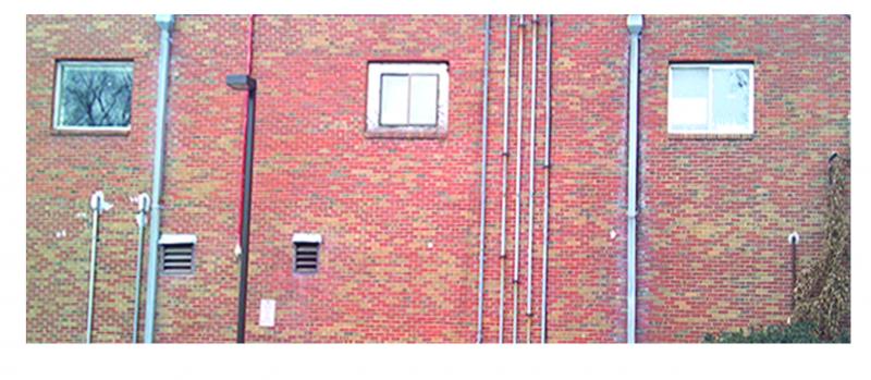

I have a customer wanting to do a mural on a brick wall (image attached). I have never done an install on brick before and have never used any type of brick wall vinyl material. I know Arlon, Mactac and 3M (probably others) make vinyls specifically for this application. How well do these materials work? What type of longevity should I be expecting (6 months to 3 years?). Also, as shown in the picture there are several runs of conduit going vertically up the building, are these going to cause problems or should I be able to work the vinyl over top of these with no problems? Any input would be appreciated.

We've had the best luck by far with 3M's textured surface vinyl. It's only rated for 6 months outdoors, everything we've done has lasted longer than that though. MacTac I believe is rated for 18 months and we were seeing failures within 3-6 months so I wasn't too impressed with it.
When bidding this remember to price the installation accordingly, this stuff is SLOOOOOOW to install, very very time consuming on brick.

I don't think you want to lay vinyl over top of the conduit...

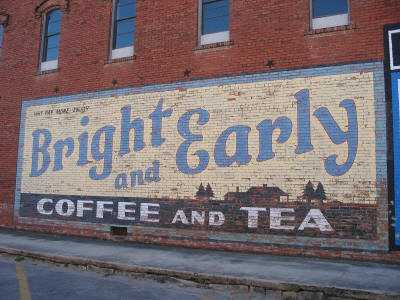

Jillbeans
And the older wall signs get, the better they look.
You can't say that about vinyl.

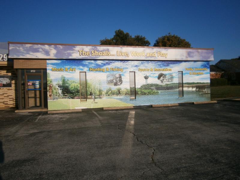

Cale Frederick
We have the front of our building wrapped with 3M 8624. It has been up for a little over 3 years now facing west and getting a full sun beating every day. Since we now try to stay away from 3M though, I have played around with several vinyls on one of our other brick buildings and they all work relatively well. They have all been up for over 6 months now and none show any sign of letting go anytime soon. Some are even calendared vinyls and are holding up just as well, however I would never give a customer a callandered graphic to go on brick.
I would not go over the conduit either. Maybe during install, but would cut them afterwards.
Here is the front of our building.
