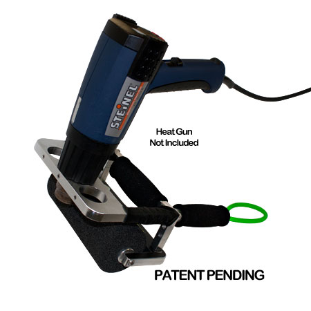

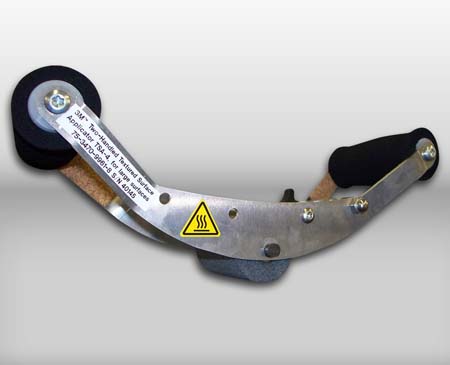

I ended up using 3M 480Cv3. We laminated it with the matching lam as well. It worked perfectly. Its pretty expensive material but is super easy to install. It would not doubt last the timeframe you are needing. I would definitely suggest buying a heat/roller tool. I bit the bullet before my installs and bought the 3M TSA-4 which was about $350 from Lowen. It is totally overpriced but does make a huge difference during installation. The key to the roller tools is that the heat softens the material right before the roller goes over to set the vinyl into the texture of the brick. Attached are 2 pictures. Once picture is of the 3M cradle roller. The other is a roller tool that GeekWraps offers. If I were buying again I would buy the GeekWraps tool. It looks a lot nicer and more substantial. It also looks like it covers a much wider swath than the 3M tool which would substantially cut down install time.
