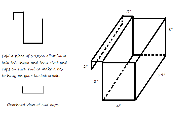

Tool Tray
Here is a diagram of the tool trays that we made with a metal break for our bucket trucks. These were made during rainy days with scrap aluminum. You can easily move them from one side of the bucket to the other and you can also take them all the way off for transport or bring them inside the shop for fab work.
If I had an unlimited amount of time, I would try to fab up some dividers because these guys always get filled to the top and the tool you need is always on the bottom.

MikePro
Aye, we fab our own from aluminum. Not removable but I don't see any reason it absolutely needs to be
