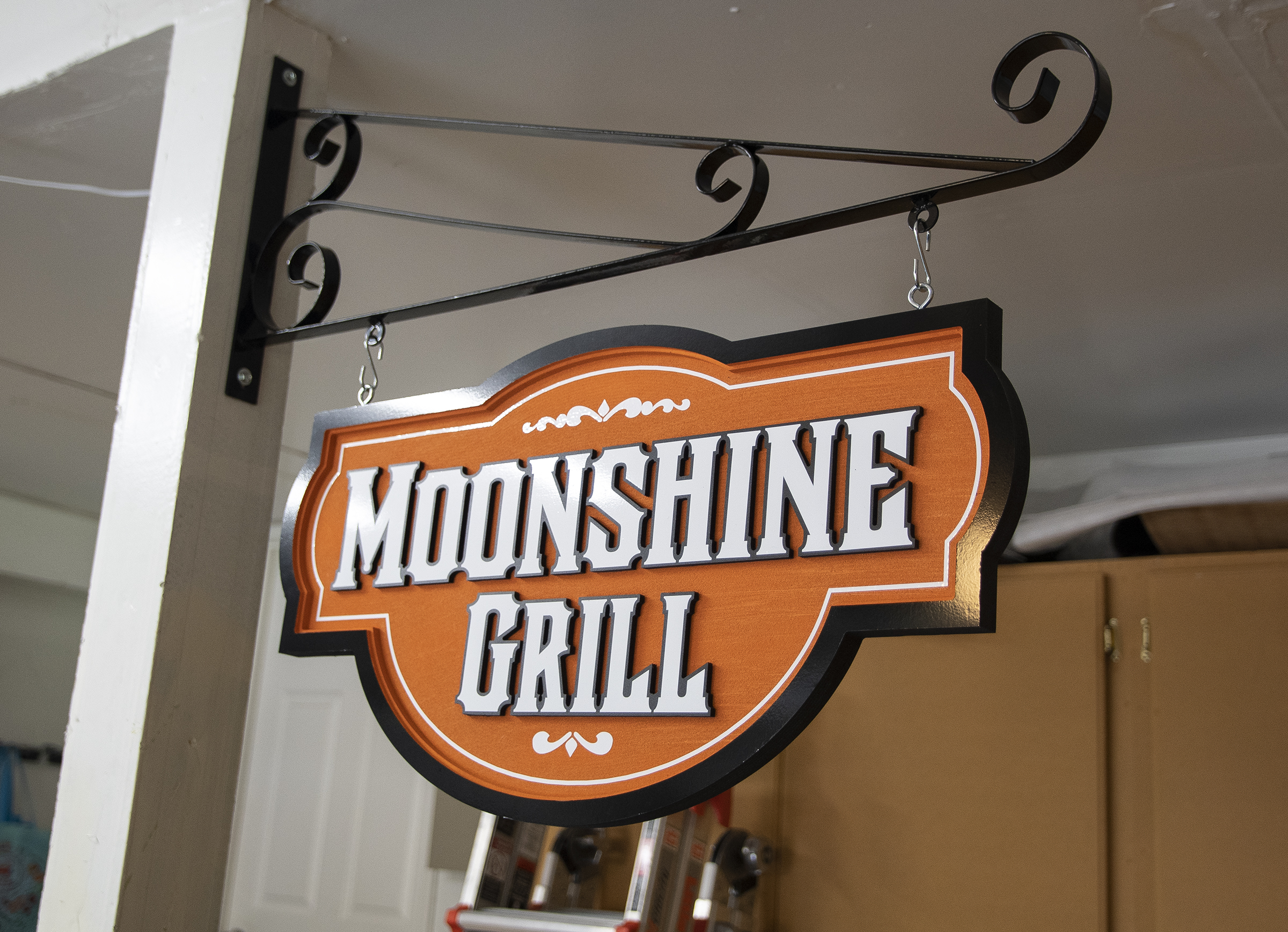

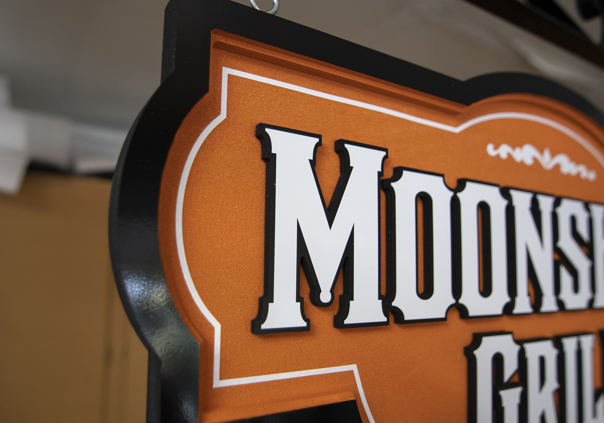

Here is the Shapeoko router and a cool little routed sintra sign I made.

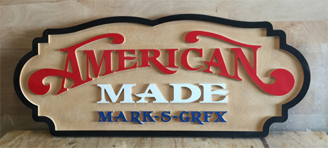

I built a 4X4 CNC couple of years ago, cost about 5K.
Picture of the machine and the 3d sign I made with it. 36 X 20
mark-s

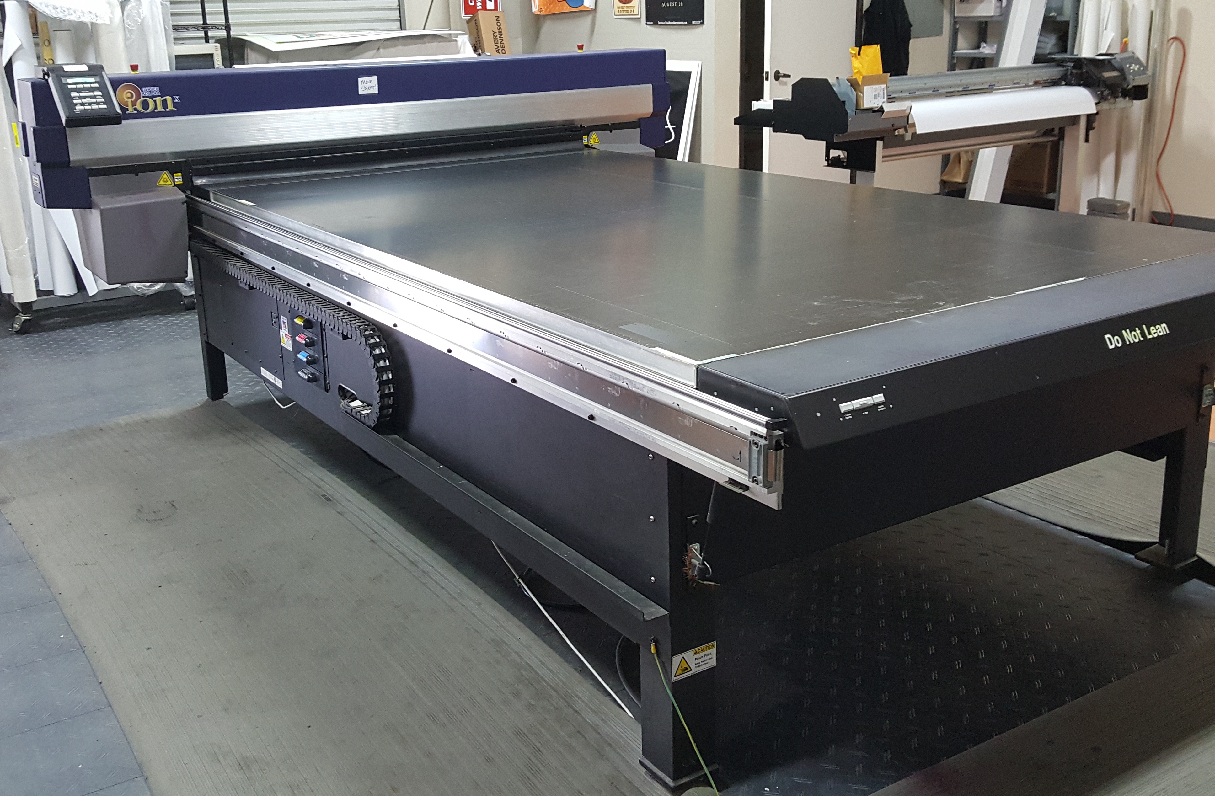

If anybody wants a seriously solid table that is already set up for a vacuum setup to hold material down, several of us here have now defunct Gerber ION Solara flatbed printers that are essentially scrap at this point. Mine has a 65"x104" table, side rails that likely could be adapted to hold your router gantry, X and Y axis electronics, etc....
