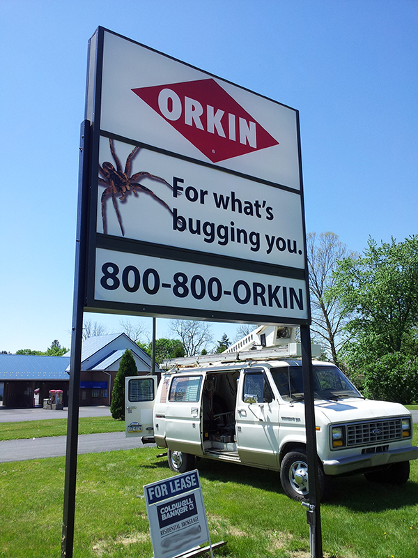

You have had some bad luck, but not all trucks are that way. A 96 is going to have some pretty serious issues and you can't find parts for them anymore other than a junk yard. Even my 05 I am having a hard time getting parts for it, but it's a tank.
Ours is a 1989 Ford. Runs great, drinks gasoline, but we did some preliminary work on it when we first bought it, but our first job more than paid for the truck and the extra money we put into it. Someone on this site knows as he was with me, when I picked it up about 4 years ago.... yikes, almost 5 years ago.. Other than normal maintenance, it's served us well. Nothing major, except a transmission line broke and I hadda pay for towing. That was more than the mechanics bill. Just got back from a job. Put 2 3' x 8' faces in the top portion of a small pylon sign and put new trim plates on the four sides. Did it all by myself. Got $1,900.00 CASH for it and only have $75. in materials invested. Took me about an hour from start to finish and it was a nice drive to boot. $1,900 in my pocket, wife went away for the weekend and I'm gonna get into some trouble tonight.
Not to mention, I use it to clean the gutters around my house, do maintenance around the house, trim out my trees, put up and take down Christmas decorations and my neighbors get to use if for free. I usually get a bottle of Bushmill on the front seat in return with a full tank of gas.
I charge out at $185. an hour. Don't have too much trouble getting it, either. Ours only goes 28' and is an enclosed van with a Telsta, running off the generator on the back gate. I have air lines running through it and when needed, I have a gas powered compressor for my pneumatic tools. I love it and wish I had bought one years ago.
Don't be afraid to get one and don't worry if it has some flaws. The stuff you can do with it, you'll work around some minor flaws.

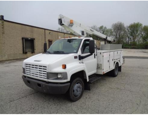

I got my truck about a year ago and love it. Its a 1998 Chevy with a 350CI motor. I keep the gears greased and havent had a problem with the boom at all.
nolanola
https://manhattansignshop.nyc/
I love the 350!
How is that type of the bucket is called?
Did you buy it locally or on ebay?
