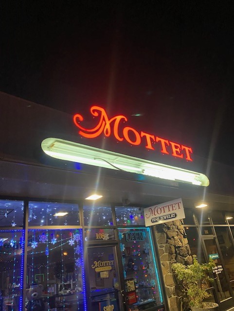

We had a big storm the other day and this sign got blown out of the cabinet. The bottom cabinet doesn't have a lip to hold a sign in. The sign that fell out looks like it had "mounting material" glued to the acrylic and then it slipped over the cabinet and was screwed in. I'm sorry as I know I am not calling these things by their actual names. Can someone help me figure out the material I need to replace this sign? I'm not familiar with how the acrylic mounts to the sign.

Do you think it was new or a retrofit, that went bad ??
I didn't go to the location to take a closer look. If I had to guess, it looks like the plastic that was glued to the acrylic failed by cracking and falling apart. I only see remnants that were glued on the back of the acrylic. The sign has been up for 20+ years.

If the bottom cabinet doesn't have a retainer similar to traditional sign cabinets it's likely the face was attached to the cabinet using channel letter trim cap material. At least that's what it sounds like.
At any rate, if you're going to replace the damaged sign face you'll have to go to the site and do an accurate survey of the cabinet in order to be able to create anything that's going to fit the existing can accurately.

New acrylic face with jewelite trim cap glued to it with resin bond. Easy fix but not cheap if you don't have a cut off of acrylic the right size, or some jewelite or resin bond.
You'll have to buy a full sheet of acrylic, a full roll of jewelite and some resin bond.

Yeah, it's called trimcap, gemini sells it along with most distributors. You'll also need some channelbond (and a glue bottle) to glue it to the polycarbonate, I wouldn't use weldon at all. Best case scenario you piece the face together and trace it onto plastic, then jigsaw it out. Worst case you do a rubbing of it.

Trimcap gets brittle over time and it breaks off easier on large boxes like that pill. It's less likely to happen to channel letters because they usually fit snug on the returns. No need for a new cabinet or lighting, just get good measurements (pattern probably isn't even necessary on a simple shape like that, or at least pattern the ends.
ProSignTN
I would use cardboard to get end radius and simple height & width for pattern. Trim cap on acrylic is a tried and true method that's been used for channel letters for at least my 35 years of making signs. Noticed the face appears to be at least 10', if not 12' long. You should be able to find 4' x 10' sheet, but if it's 12' you'll have to splice it. Glue pieces of clear behind each side. Stagger the pieces so that when pushed together they lace together like the fingers on your hand. A strip of HP vinyl on the front side to cover the seam. Or glue one clear piece on back of both panels.

I'm surprised trim cap hasn't been improved upon. In my experience it's the first part of a channel letter sign to fail.
We have trouble with wholesale manufacturers not putting enough screws in faces like that. We also have to re-glue the faces frequently.
You could make the new face with 2" trim cap for a little better durability.
