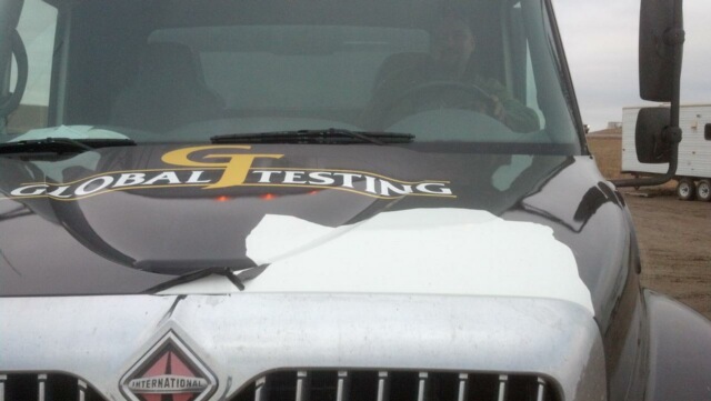

for those who think wind damage doesn't hurt.
We did this back in Oct. 1 week later this happened. My guess is that my installer who did the hood, didn't tuck it into the grill all the way in that area. This is the result. I'm trying to save everyone the hassle of doing something twice.

Good discussion going on.... and no one is stoopid or crazy because of how they do things.

again, apples to bananas....
