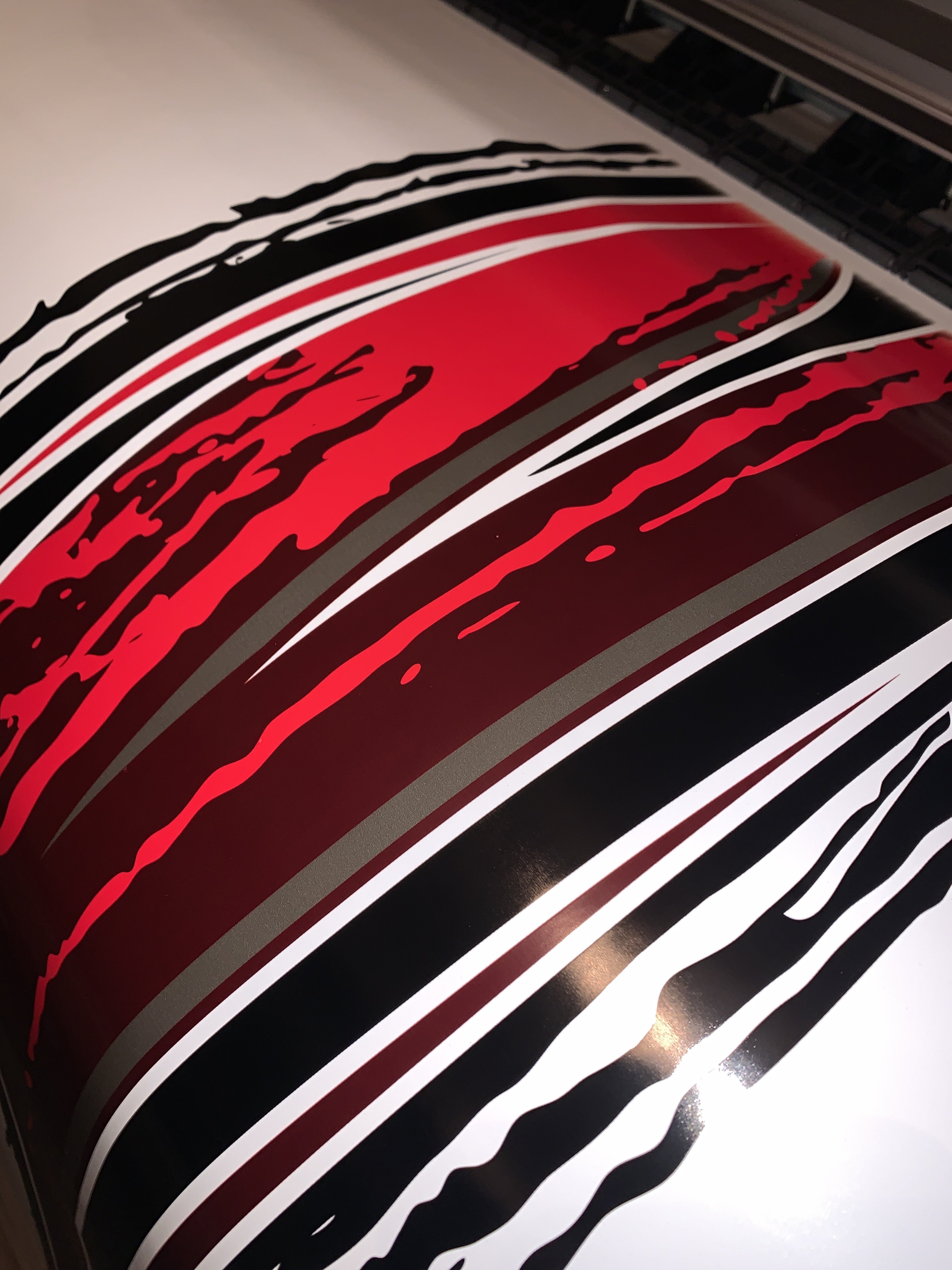

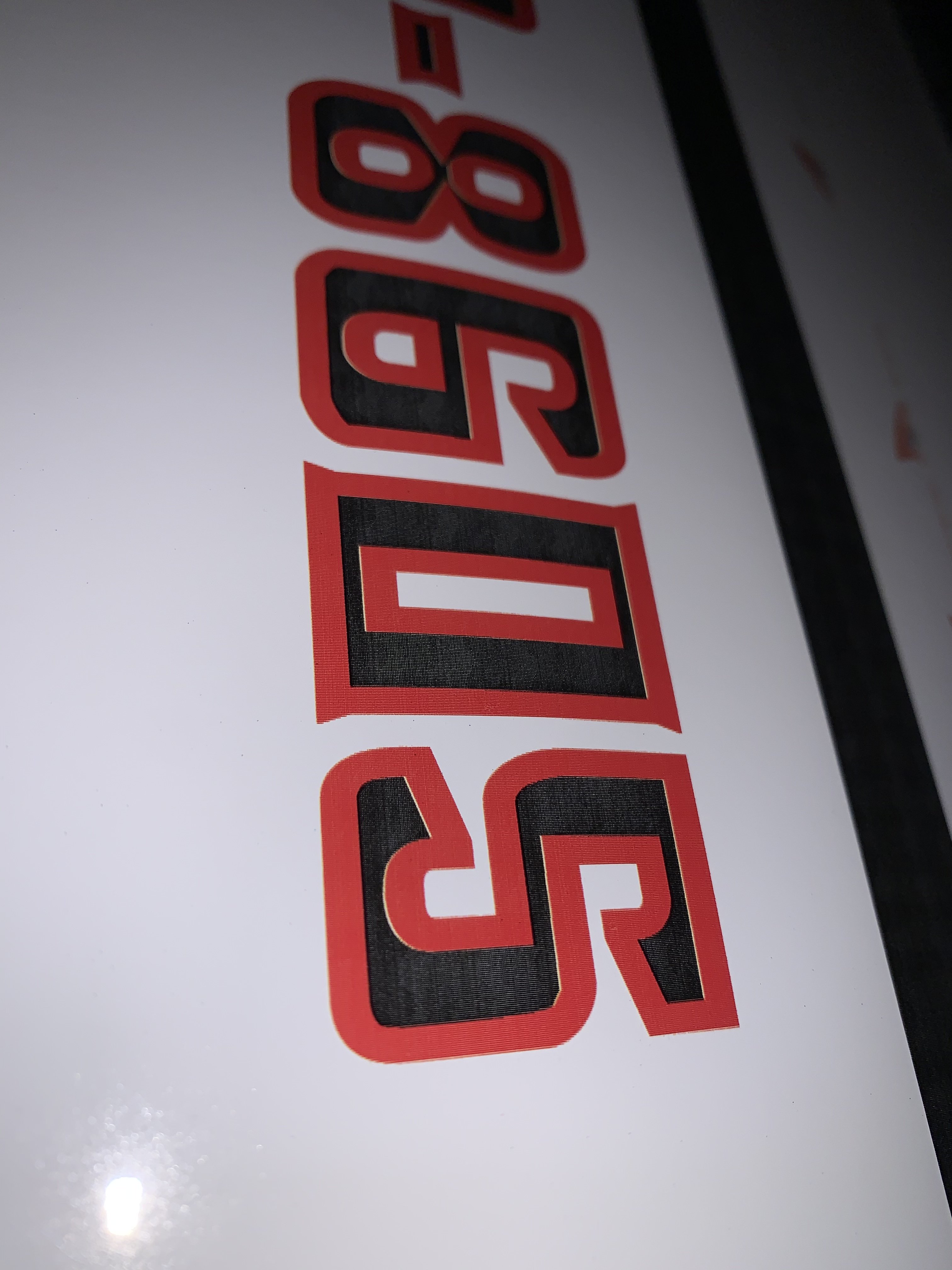

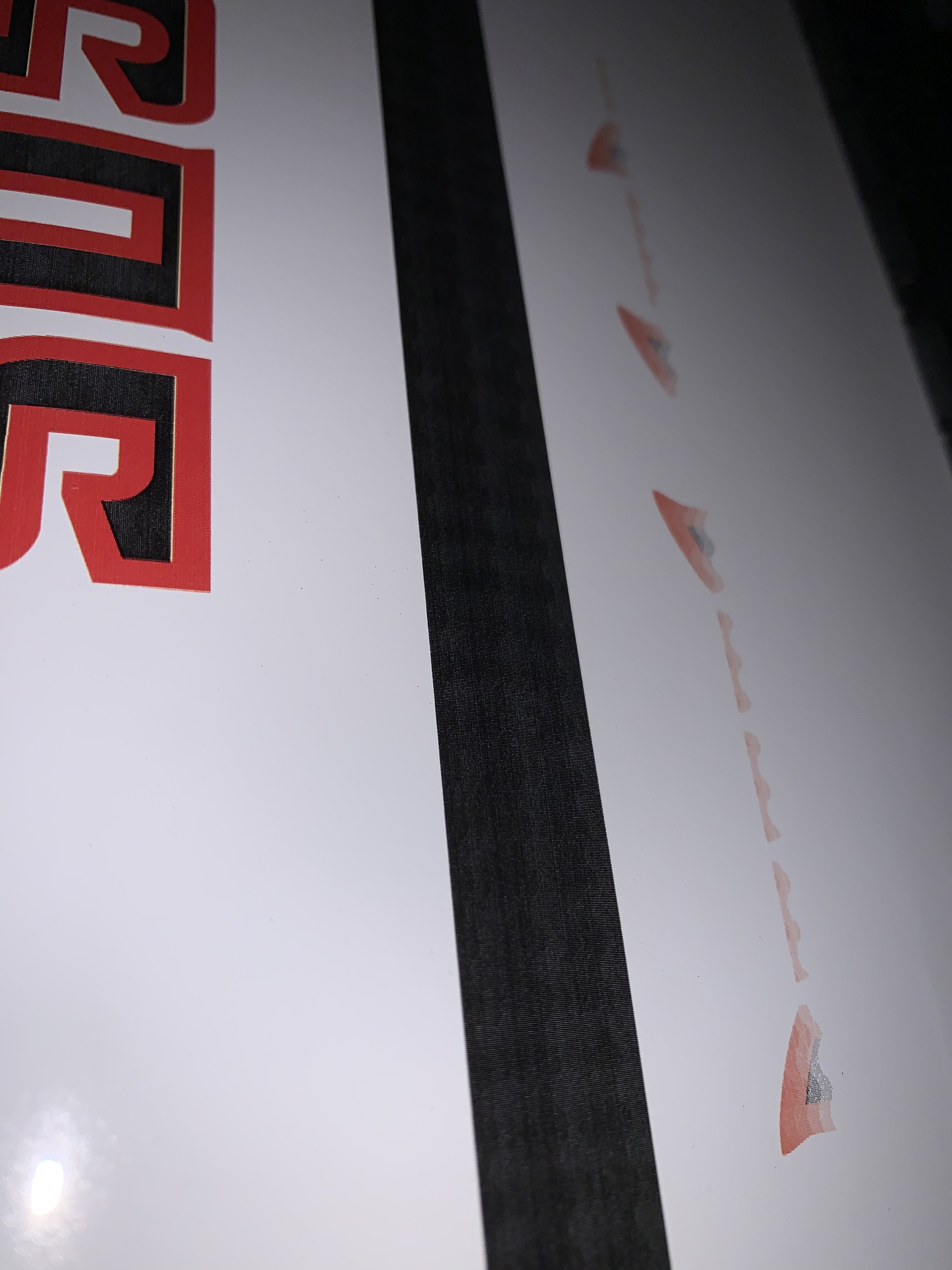

I am having trouble getting solos colors to print from my Mutoh1204 using Flexisign. I’m printing on Oracal3165 and using Oracals color profile. Anyone have any suggestions?

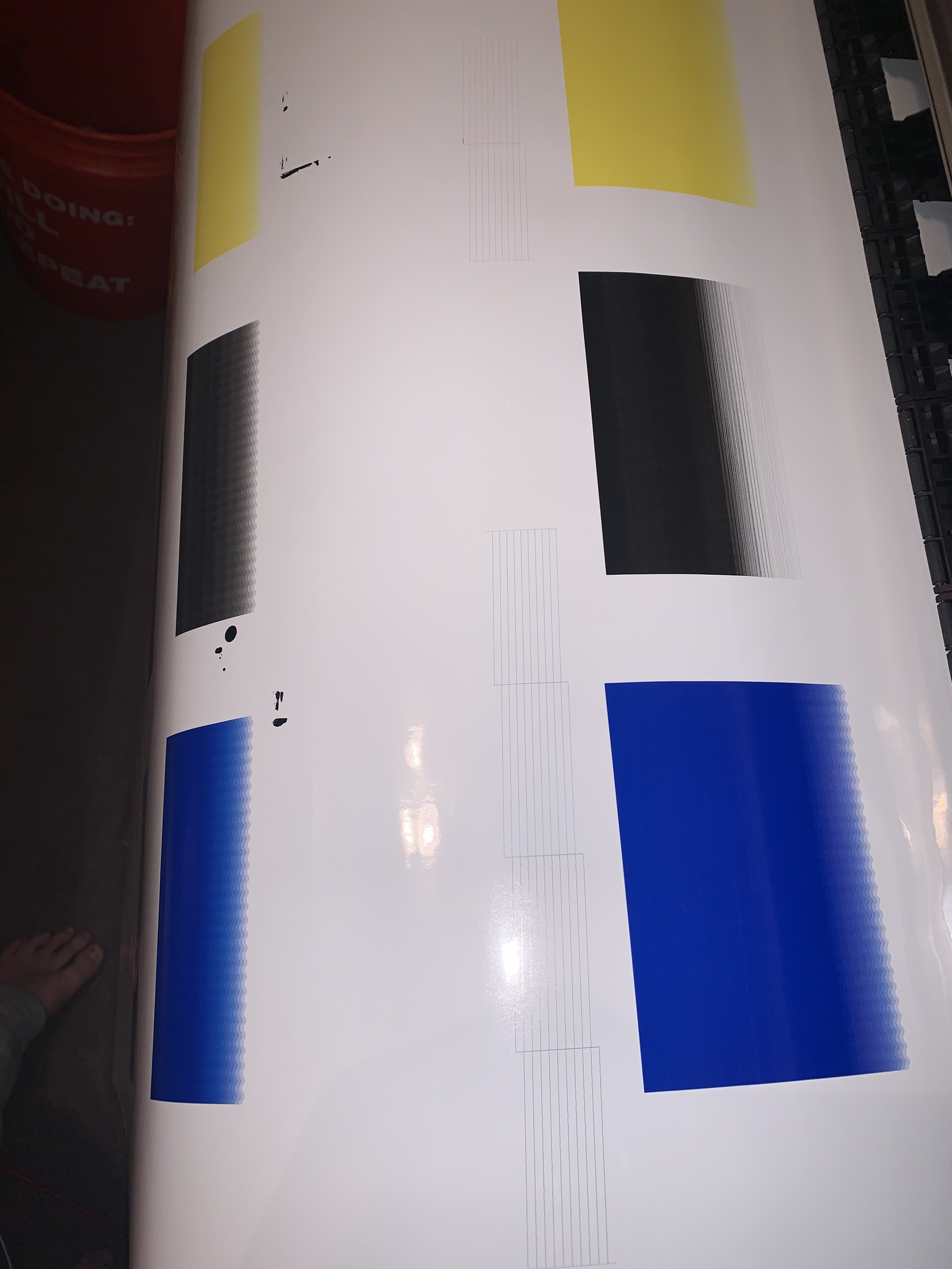

How is the nozzle check, can you post up a photo of it?

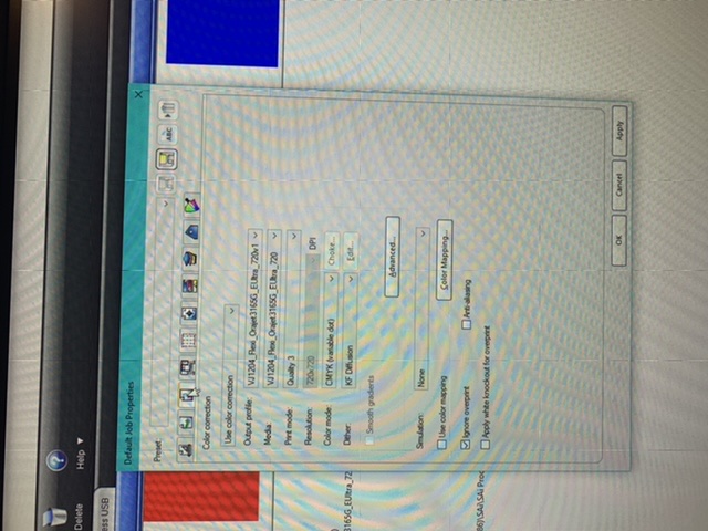

Nozzle check is just about perfect. I’ve attached my settings that I use in production manager. I did try a different setting to try and get more solid prints, but it didn’t help at all. I have not tried a different roll of media.

Also need to know how many passes? I zoomed in on a photo and it looks like you printed on canvas...pretty strange pattern. I'm gonna suggest another vinyl? Looks like maybe that's a bad roll.

I changed the effect, dither and quality and now I’m back to getting nice solid colors again. This is printing on Oracal3165 vinyl.
