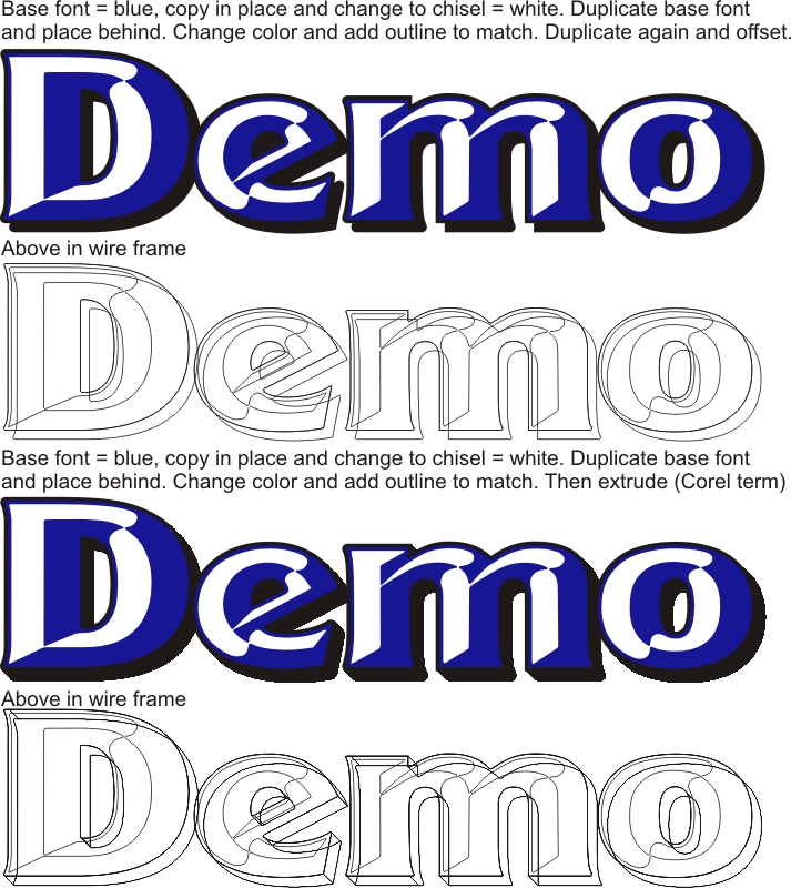

Here are some examples for printed graphics. If you are cutting vinyl you will have to use contour and weld in place of outines.
Jester1167
LOL, thats not a function, it's a tutorial on how to do it manually. Still cheaper to buy than make, unless there are only a few letters.
