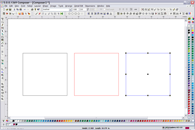

Suggested Toolbar Setup for Omega
Here's a screen shot of my Composer workspace. I suggest you click on the View Menu and then click on Toolbars. From there you can bring any of the available toolbars into the workspace after which you can drag and drop them to available space on the top and sides. This provides a number of benefits including:
  • Quick access to any tool
  • Tool tips and keyboard shortcuts when you hover over any tool.
