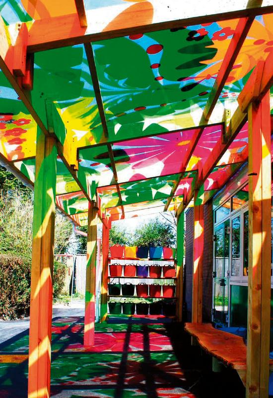

I have been given a job something like what I have attached.
This was created by applying translucent vinyls over the inside of the panels.
What I am trying to do is print a pattern something similar to this and apply it is a single print.
Question is can I print onto clear with my Mutoh Valuejet and then laminate it?
Will it look as good?
Also will it last, as I can guarantee colours from fading on a standard vinyl print but in this case the light is going straight through.
Thanks

I would almost say that that was made with transparent cut vinyl, not translucent cut vinyl
If its transparent, double-hit digiprinting should ​look similar, but if it is indeed translucent, a digital print would be extremely weak compared.
scott pagan
or you can oversaturate a single print on translucent vinyl. a 20% levels boost at RIP gives us great backlit prints. may need to print test samples for the windows/ light box to get the right % you need for optimal color.

I tried a double pass test print last night laminated it and it is now on our side window.
Looks the business :)
Thanks All
