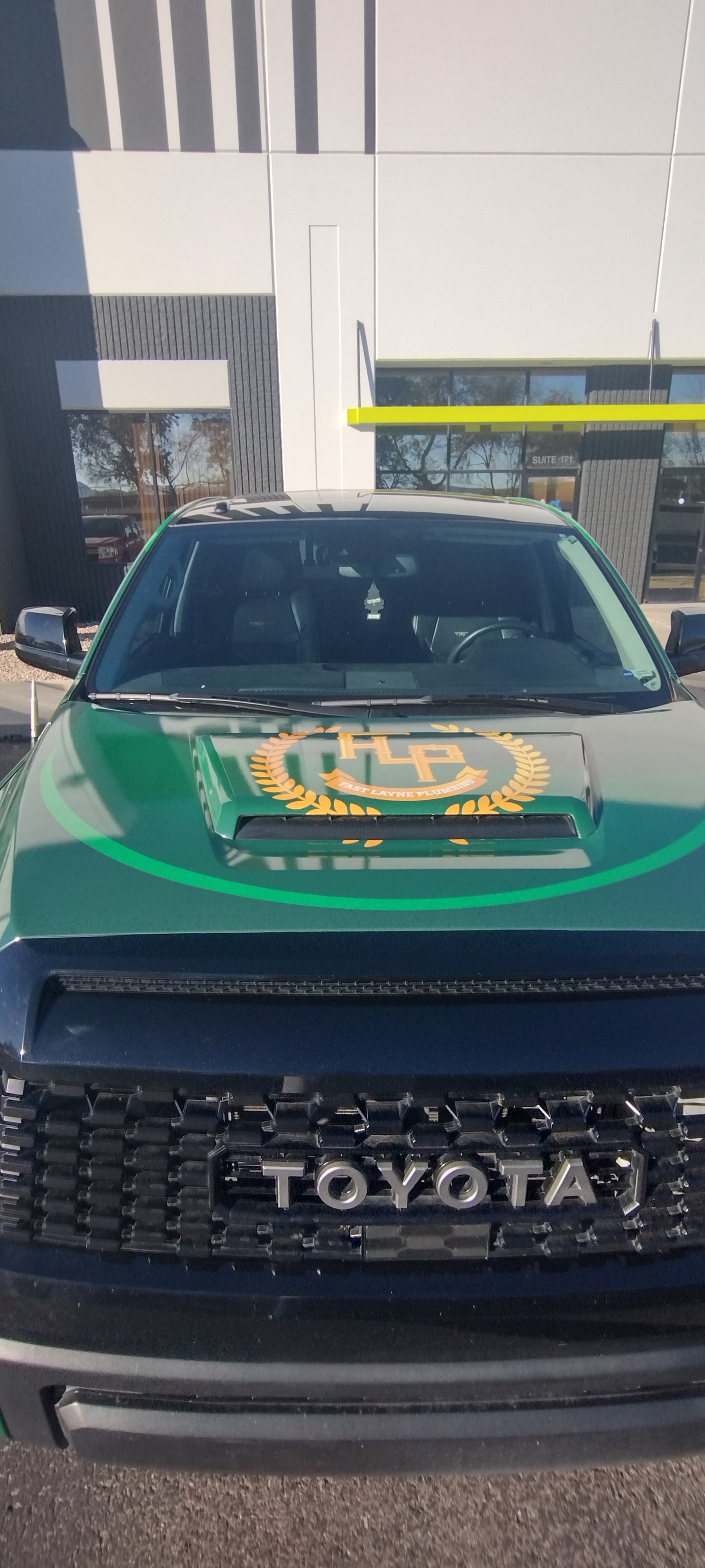

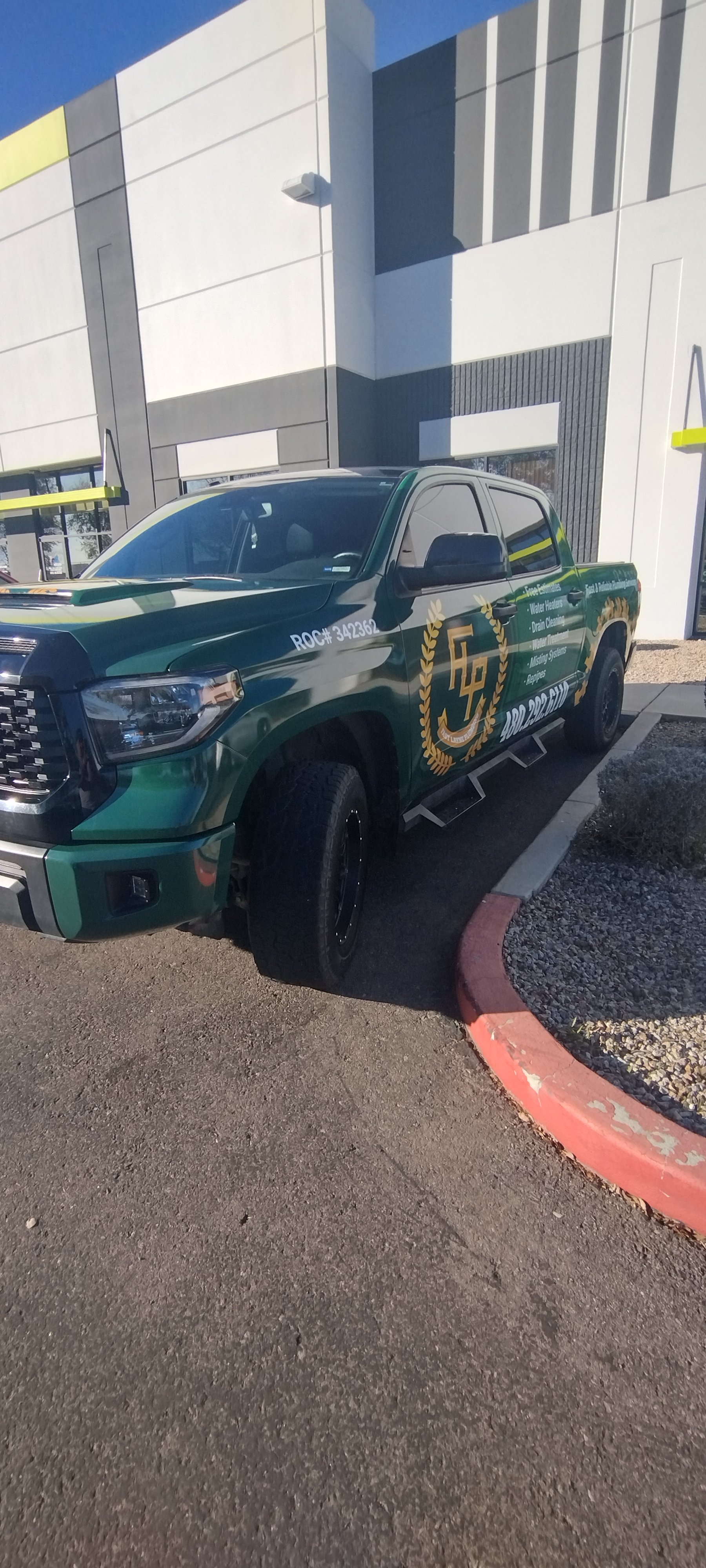

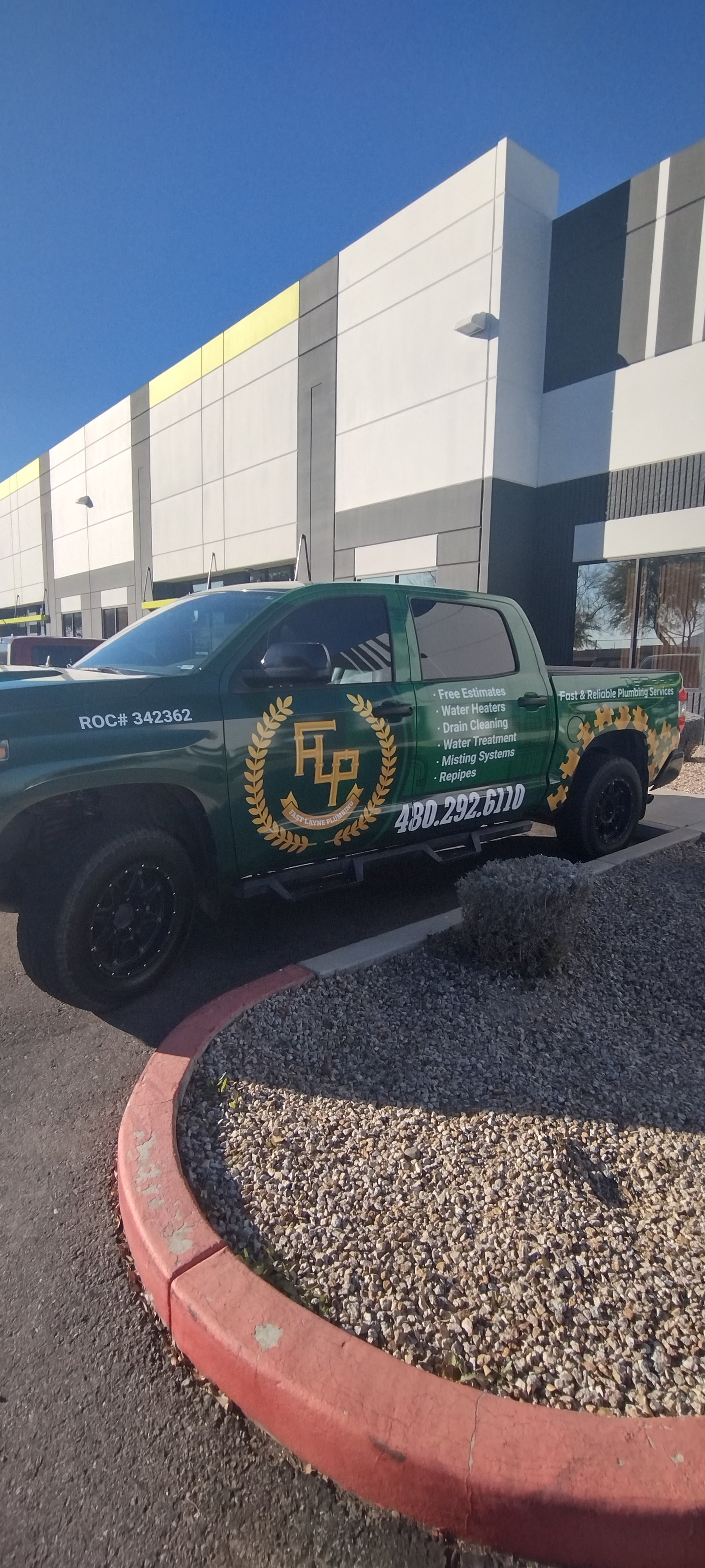

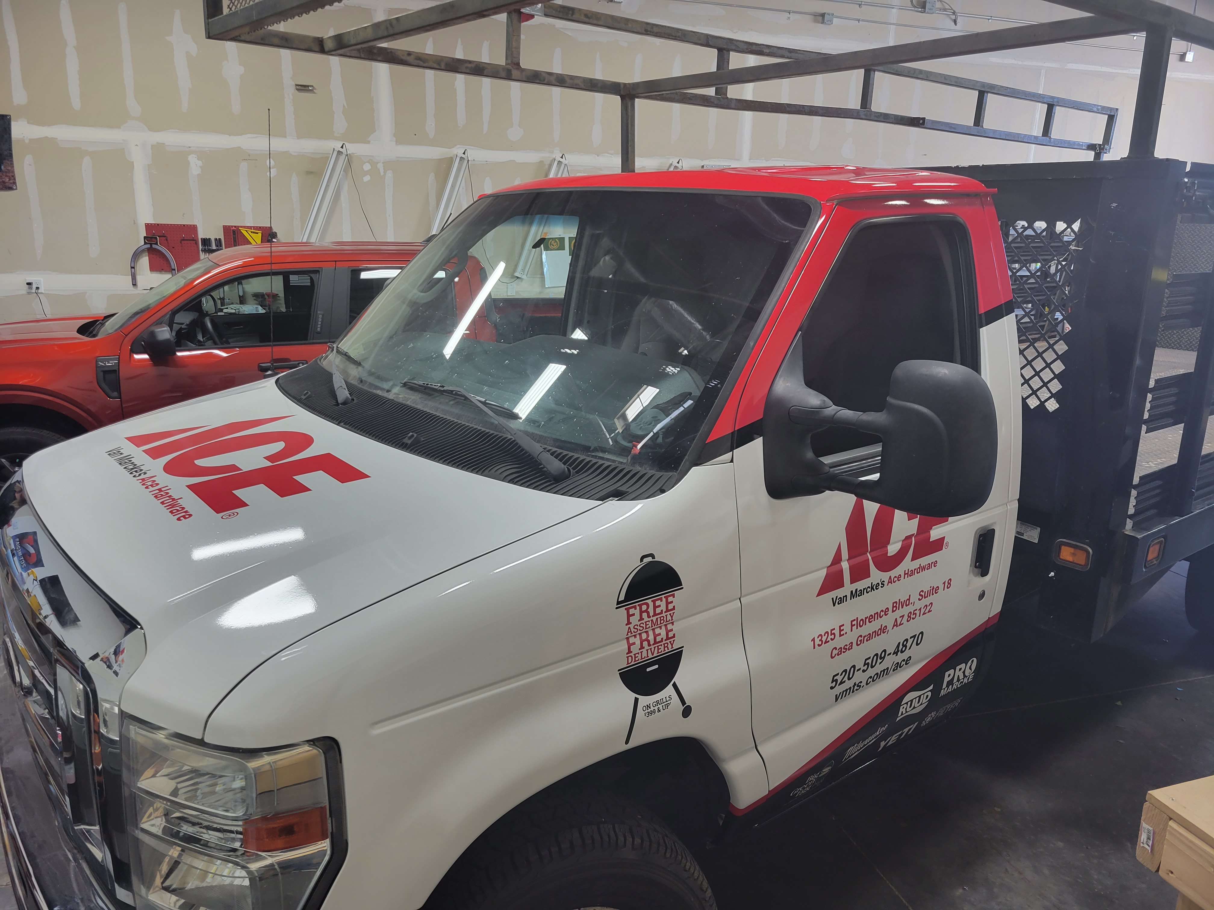

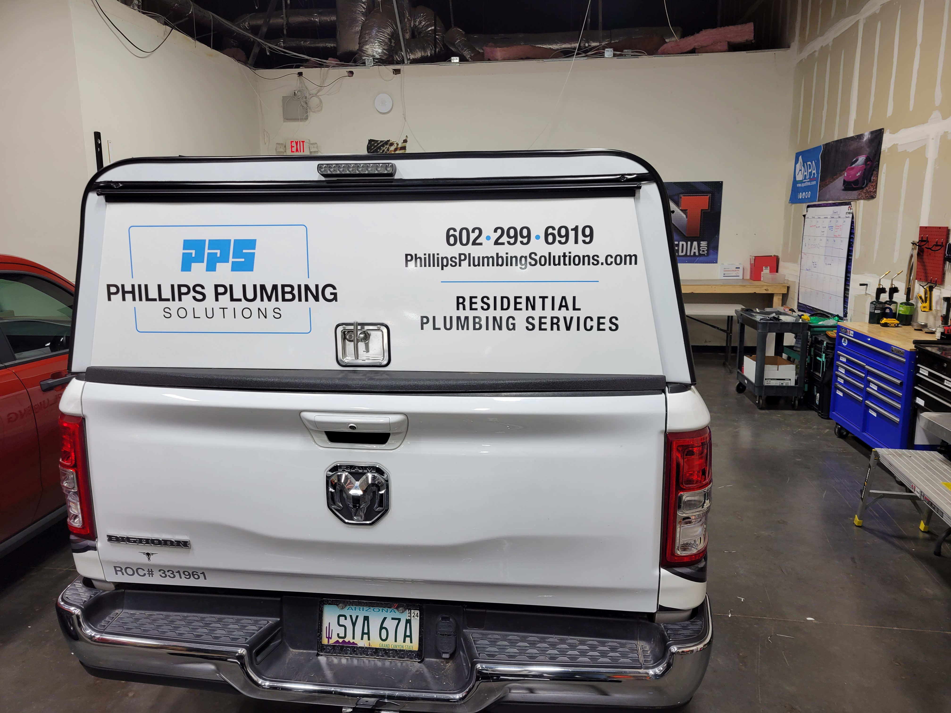

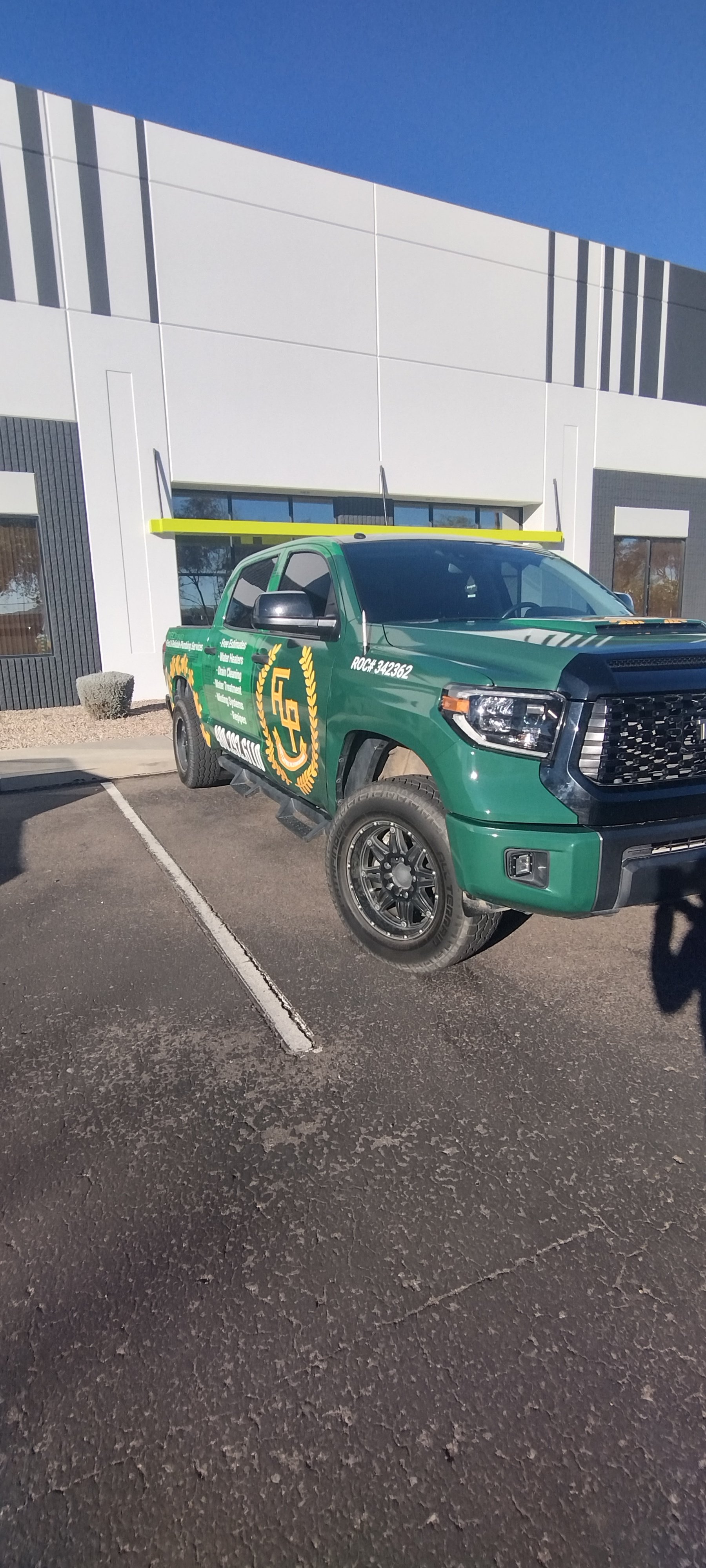

I'm waiting for my team to send me the full wrap images we have done recently but these are all 1650 Wraps

Here is one of the Full Wraps

Thx for posting these, have you guys done much with deep recesses? Seems much of what I'm seeing is "non-complex" curves, any known issues for you guys with laminating this ink set? Thx again!
Because we do primarily commercial vehicles we do things differently to prevent failures down the line. The issue you will run into with the 1650 is if you do narrow point stretching, but if you stretch over a broader area then shrink back, it works significantly more consistently without ink breaking.

Those wraps look great. Curious what you mean by doing things differently to prevent failures? Do you cut and drop the recesses? I've always struggled with how do address things like that on commercial vehicles - that's all we do and we know our clients want their graphics to look good but sometimes there are things (like leaving recesses blank) that can help eliminate failures. I'm assuming you have a system/script to go over things like this with your clients?
It's really cool to see what you guys have been achieving with Colorado prints - definitely on my short list of printers to buy after we pay off our current equipment.
So because we are primarily focused on vehicle graphics for Commercial use, we spend a lot of time explaining the ROI and return-generating aspects of the wraps/graphics. During this conversation, we explain what affects and what does not affect the return; we also evaluate if the exposed channels/recesses would hurt their message, logo, or image. Then we decide to either Cut and Drop or inlay. We prefer not to redo projects for avoidable reasons, so a paint-like finish in certain aspects is not our top priority or the clients when it's all said and done.
We ultimately ask three questions to ourselves and the client:
1.) Will this reduce your exposure / prevent sales?
2.) Will this alter your brand impression?
3.) Will this change your client experience?
If the answers are NO, we avoid doing the riskier work and stick with tried and true methods.
