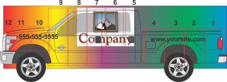

Printer size? Vehicle? Actually, doesn't matter. Vertical panels always. And Customer is always right. Especially about their color scheme. Make sure logos are always centered and as high up as possible for visibility. Put the phone and website where they tell you as well. And if they don't have a vector file of their logo, just use the jpg they scanned of their business card. The illustration below should explain it all. Good Luck.

I would have done that truck in 2 horizontal panels. 1 lower section full length and 1 shorter piece for the cab. much faster and no worries about lining up the phone numbers and getting them straight.
I like to use an actual photo of the vehicle. Sometimes when you use the outlines then the actual truck shows up with extra hardware that affects your layout.

we minimize seams as much as possible. If the door is 48" wide we print that panet at 52" and center onto the door and so on down the line. Wraps look much more professional if they are seamless.
Very rarely do we do anything in vertical. Even large semis we do in two horizontal pieces. The fewer the seams the fewer the chances for failure.
I hope this was an attempt at humor...
A truck side like this should be 4 pieces - 1 for front quarter, 2 pieces for the doors, and 1 for the entire bed side. Same for other side. 1 for tailgate, 1 for hood, and of course 1 for roof, if applicable. Good design can keep you from doing the roof.

18"??? geez.
2 horizontal panels and done. we peel the entire backer off the long full length panel. one person on each end pulling it taught. third person in the middle check alignment and placement with pushes in from the middle out to the sides while the outer guys keep the tension on the panel.

The best way is to have a single panel run the length of the entire vehicle. If you have 2+ people installing it, you align the panel once, remove the entire backing paper and install. Takes more caution on the setup side, but install goes faster. This does require an interior bay, which I've rarely had access too.

Most of our wraps have been outside, so we broke it down into sections: front fender, cab/doors, back fender/bed, hood, trunk/tailgate, roof. This allows you to only worry about one section at a time, which makes it easier to install under the conditions I've had when wrapping. The trouble is that you have to align each panel as you go, so if you get off a little on the first, it gets worse and worse.
Btw, I don't recommend doing a full wrap outside. It's worth the money to rent a bay somewhere for the install, if you can find one. But I wasn't the one making the calls, so we did them outside our shop.

So for the 18" wide printer I used for the illustration...I should just do 4 horizontal panels? Got it. ..thanks.
I don't think my customers would be happy with that many seams in the graphics. We get enough comments on trailer wraps about the seams using our 54" printer.

So should I make panel #12 2 horizontal panels instead of 1 vertical one? Since there is a light splitting it?

No just wrap over the light. That'll make a nice disco scene on the roadway at night with the background you selected.
