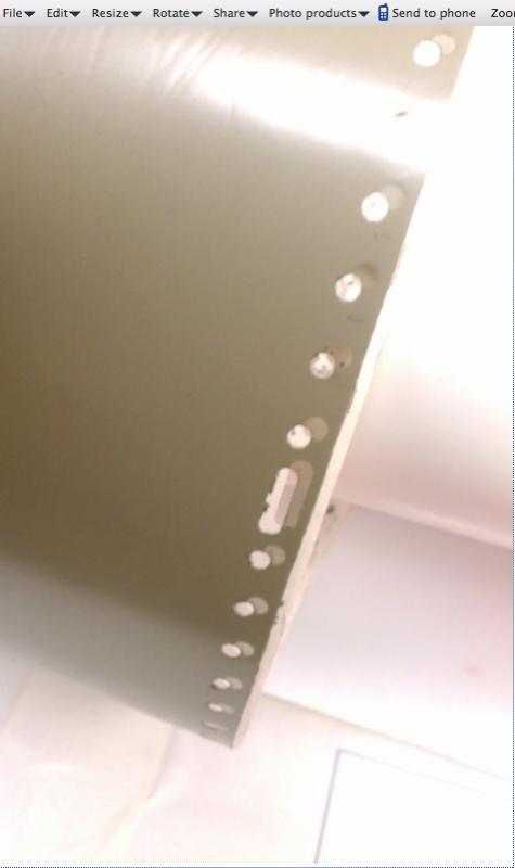

calendared, in a climate-controlled shop:
(off the roll even!)
