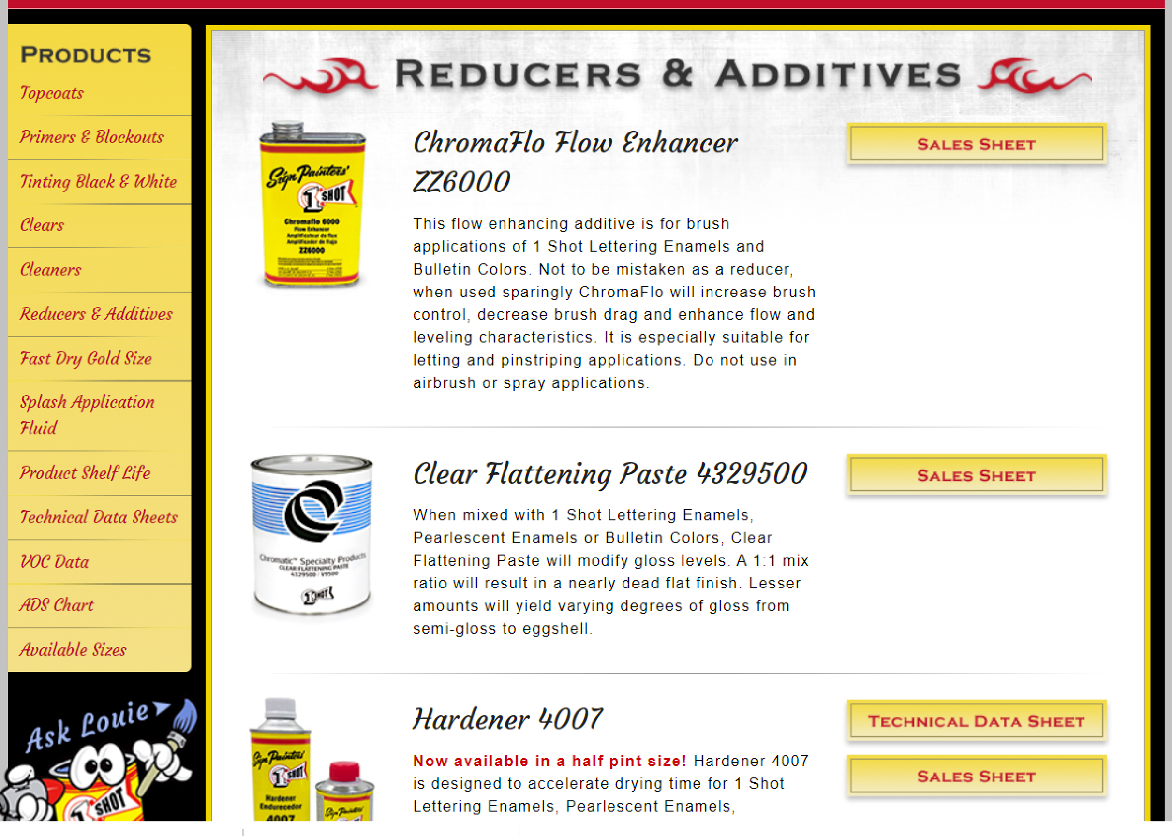

This is the product, from One Shot's webpage.

Yes, it works good. If you want a really matte finish, you have to put a lot of paste in which makes it not cover as well. Just takes more coats.
