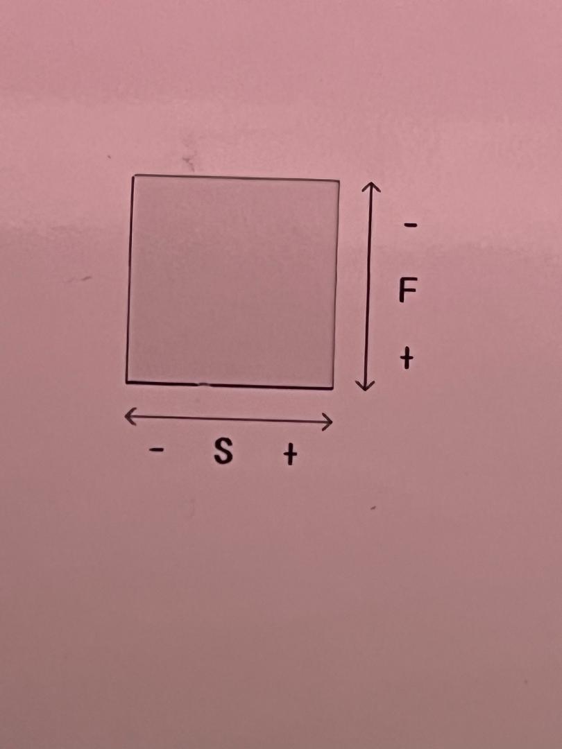

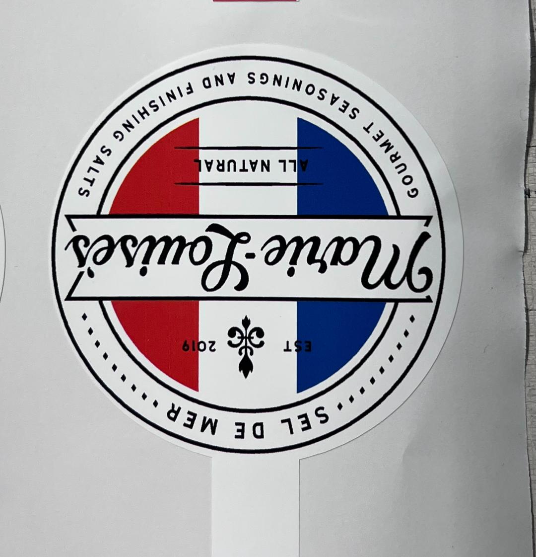

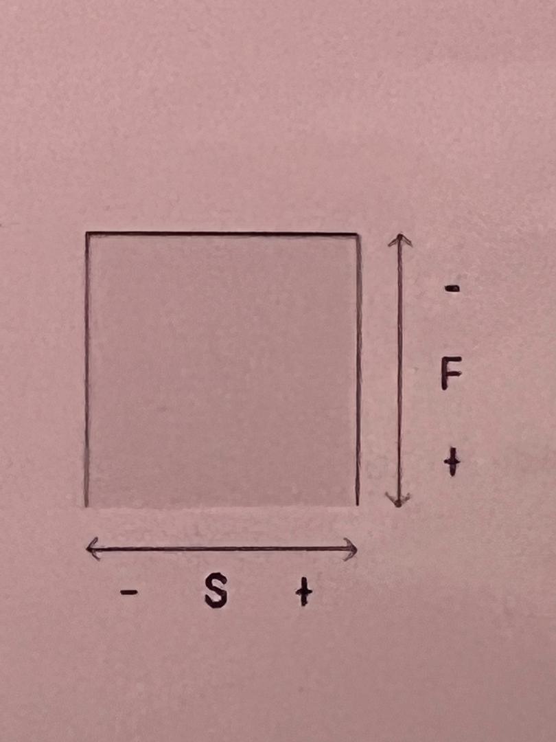

I found this thread because I'm experiencing a similar issue. I'm going down the list of everything mentioned in this thread (thank everyone for sharing your insights) but I wanted to see if anyone recognizes this symptom . (Roland VG-540) when performing adjustments to the PRINT/CUT function, the test print is two small squares, on the far left and far right of the media. it prints and cuts around the edge of each square, and the user makes adjustments if any overlap is visible. My test squares are cut drastically different. The right side has overlap on the "upper" part of the square (F-) and the right test has overlap on the "lower" part (F+). So do I adjust up or down? The job I'm trying to print is cutting poorly on both sides and the center. Pictures below. Any thoughts or insights are greatly appreciated.

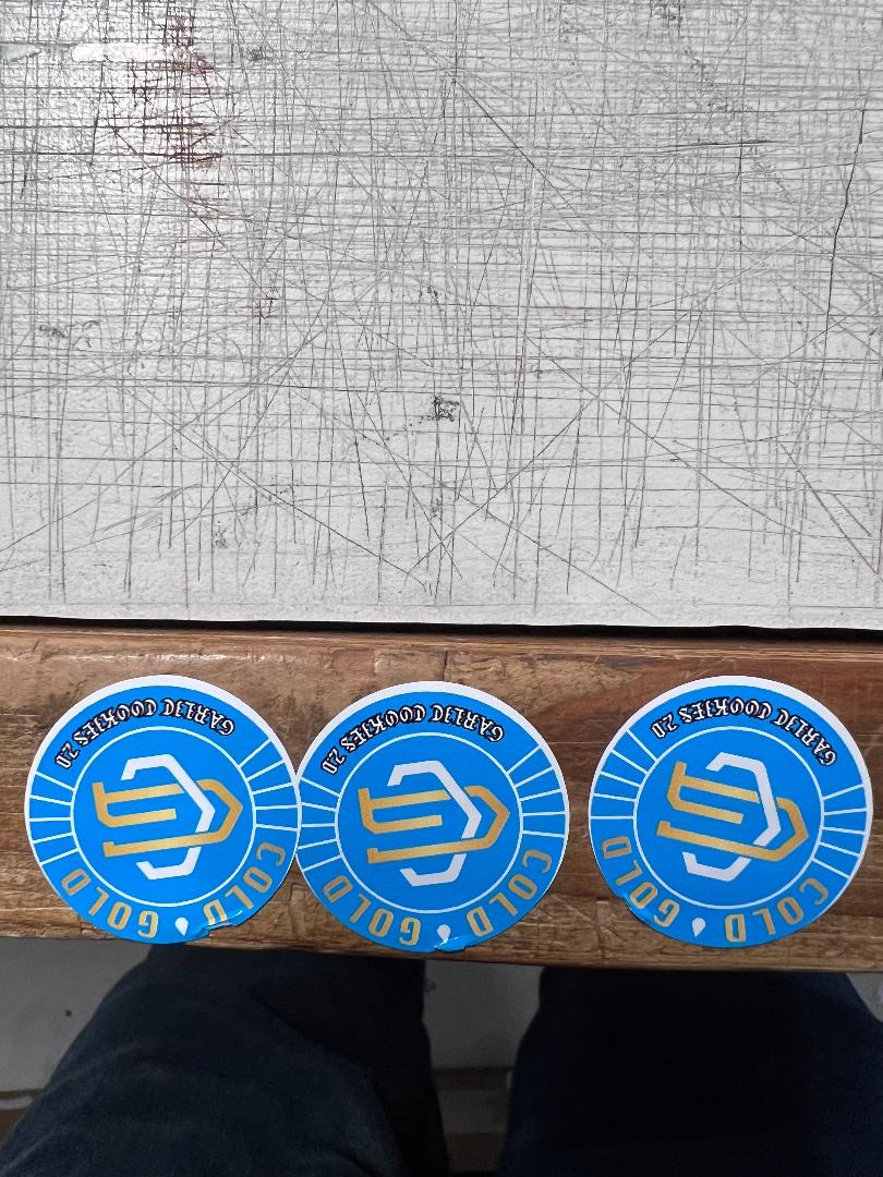

We are trying to do circle decals and the border is always off like shown in the picture. Our designer says it’s near impossible to center art work on a circle with small border. Is this true or is there more he can be doing?
Your design guy is doing his part of the job. Aligning artwork in a circle is as basic as cut, copy and paste.

You want to hit -f or feed so that you see equal black all the way around the
My fourth pic indicates that, but the third picture seems to show I should adjust towards F +. They're from the same test. It prints one square on the left and one on the right. I guess the idea is to try to split the difference, but what does one do when the two sides suggest opposite adjustments?

Yes & no. I'm troubleshooting a similar issue on my VG-540. Mine is cutting everything wrong right now, but even when it was working, my calibrated printer could get away with cutting rectangles at a faster cutting speed than circles. When I try to do the circles at like 30, they come out looking like sticker bro's pictures, and sometimes slowing it down to 10 would help.
Take out the expensive vinyl and put in the cheap stuff.... write your current settings down and experiment with big changes. Also....pay attention to the decimal places. IIRC, I was chasing a setting back and forth while losing my mind. The program was calling for changes in .01" but I was making changes in .1"
Don't be afraid to push buttons and waste ink and vinyl getting to the bottom of the calibration.

Some what of a rookie question here since I am not a designer. I own our print shop but I do not do our graphic design. We are trying to do circle decals and the border is always off like shown in the picture. Our designer says it’s near impossible to center art work on a circle with small border. Is this true or is there more he can be doing?
We are using Roland VG2 and Roland Camm 1 GR2
My StickerBrothers. I've been dealing with a similar issue on our VG-540. Many sticker/label cuts coming out misaligned, especially circles. I tried much of the stuff suggested in this thread before calling Roland himself, and using all pinch rollers helped a lot. Also the stuff people said below about extra bleed and margins was a step in the right direction for me. And then Roland just called me back and said worn out or damaged pinch rollers is the cause of much print/cut alignment issues. I'm ordering a new set now, and Roland said he will walk me through replacing them when they arrive. It adds up too, the pinch rollers are as old as the printer, and our newer VG-2 doesn't do it as bad. Feeling optimistic. Good luck with yours!
Tomi G
I have been designing for over 40 years and I have to say, I never heard that you can not center design work using a circle, I would be more then happy to look over the file or even recreate it for you to try, anything can be centered if you know what you are doing and if you can not then you have to look at all the elements of the design and find what is causing you not to center. Just my 2¢
