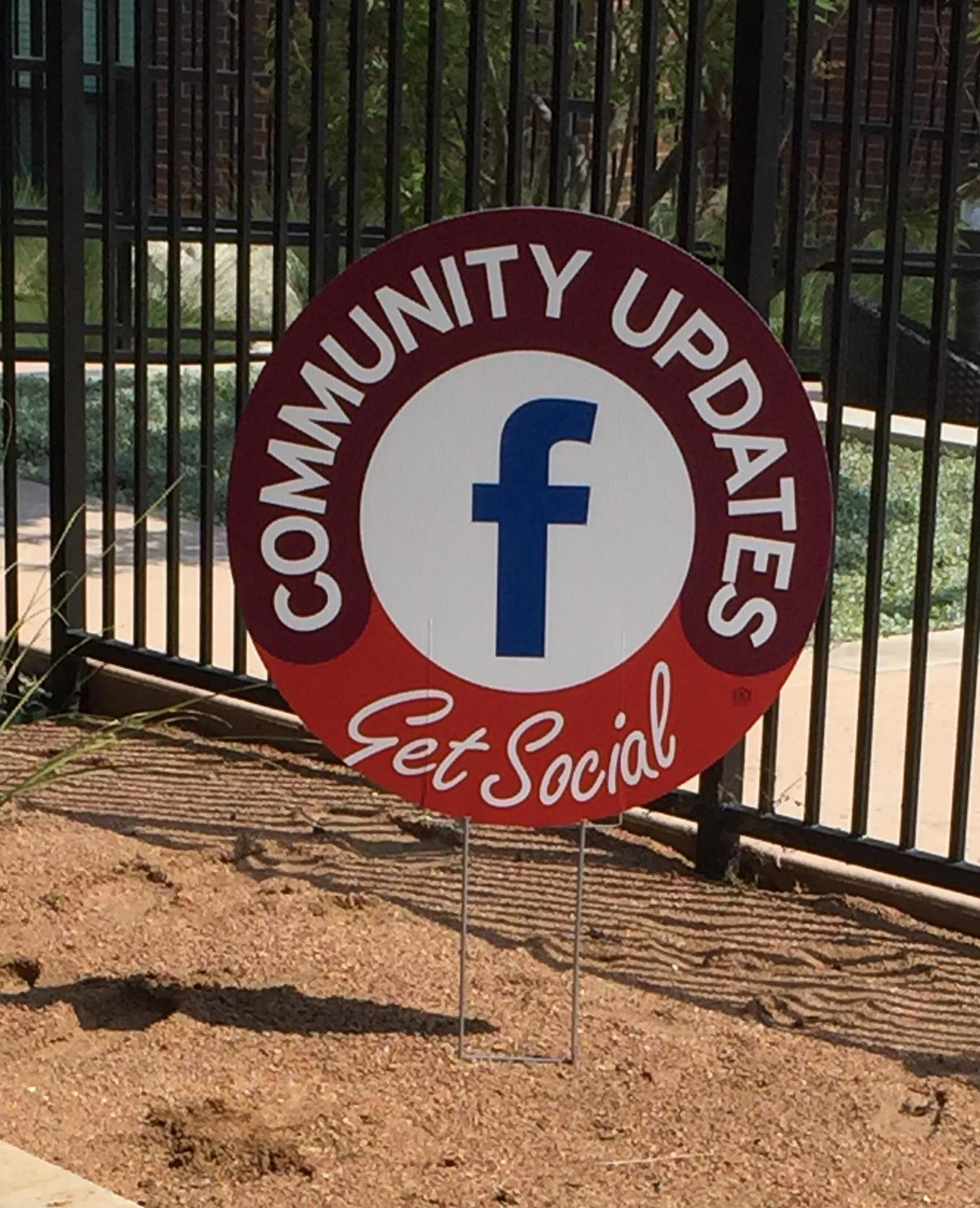

A customer of ours wants so circular yard signs that are 32". What would be the best way to do this? Is there places that sell these pre-cut? I tried cutting out by hand but it is not perfect
