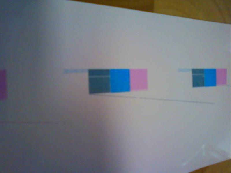

midnightmadman
Its from my phone so its a little blurry. but here is what I got for the first check.
randya
This is a two head machine and it looks like you have most of one head, and almost none of the other.
Definitely get some clean room wipes and do the head soak.
You should closely examine the caps and the alignment on the head that is mostly plugged.
