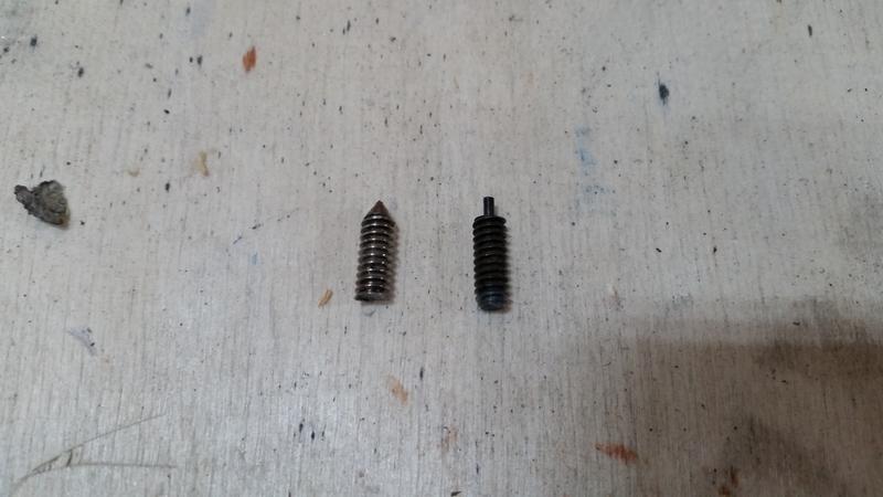

Assuming it is a standard Gemini font and not a custom logo -- Gemini has all their fonts available for download from their website. Download them and you'll never have to buy a pattern from them again.
Determine the letter size. Download the fonts. Make the pattern before you ever leave your shop. As others have said, stud placement is not uniform. You'll have to place the letters on your pattern and mark studs by hand on-site.
Attached is a photo showing the tool Gemini uses to mark their studs after the letters are made. It's one of their standard studs, shortened with a sharp point. On the right in the photo is the one that comes from Gemini; you can make your own, like we did on the left, by taking a standard 10/24 stud and grinding it to a point.
