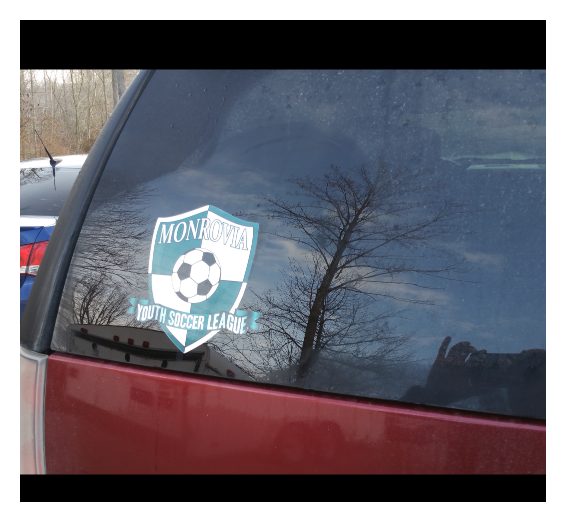

Hello all, I'm new here obviously so I'll introduce myself whilst I ask for advice to save time. I'm merely a hobbyist making decals and cutting small designs and have recently started making printed and laminated decals. I also dabble in t-shirt design using JPSS and Opaque. I have an Epson 1430 and a silhouette cameo (for now) that's gets the job done. I've made a few decals for the league and printed laminated and contour cut them and I think they turned out quite nice for an amateur but that's for you to decide.
I use cobra pigment inks and I think a 6 mil cold laminate on papalio printable vinyl that's seems to adhere well during application yet a few trips through the car wash and the edges peel a little bit and the ink starts to wash away. I have tried cutting a larger contour on the laminate to attempt to seal it but it makes the decal look like hot garbage and very amateurish also the laminate does lay down flat it has a slight crinkle to it.
Anyone have any workarounds for a more durable decal perhaps a recommended cold laminate or a technique that I'm missing? BTW the pic doesn't show the peeling, that came after a few car washes.

Use quality cast vinyl and laminate. Allow 24-48 hours to dry before laminating.
Thank you I did allow it to dry for 24 hours and it seemed dry. I'm not sure if papilio is cast or not. Guess I better look at a more premium cast vinyl and laminate. :thankyou:

You're on the right track with cutting your laminate larger than your decal. Basically, your aqueous receptive vinyl has a coating so your epson can print on it. However, the cut edge is basically leaves that coating exposed to the weather and moisture is wicking under your laminate.
So, get yourself a cast laminate, usually around 2mils in thickness, and overcut your decal by 1/4" or so. It wont look as butt ugly as that 6 mil junk that you're using now. YOu will however, have a trapped air channel around the edge of the decal itself but it will be minimal with the good laminate. You may get a good year or so before significant fading depending on the quality of your pigmented inks. Back when I had an HP5000 I experimented a bit and what quite surprised at the longevity I could get with a good laminate and quality coated vinyl.

Like Bill, I also had an HP5500 with pigmented inks.
Encapsulating the decal by sealing the print down with the laminate is the only way
I ever got the laminate to stay on.
I tried several different vinyls and most were short term, the longest lasting I found was the 3m coated vinyl
and matching laminate. Think is was the 3m 8522 and 8519 laminate.
Actually had prints last 6/7 years, but it was pricey and hard to compete with solvent or ecosol printers with lower
material and ink costs.

your laminate is probably too cheap. right now on fellers.com they have a 54in roll of Arlon for $100. it's the cheapest I believe in their site. get that which should work a lot better. it's 3.2 mil thick and last longer than any 6mil would. anyways hopes this helps.
