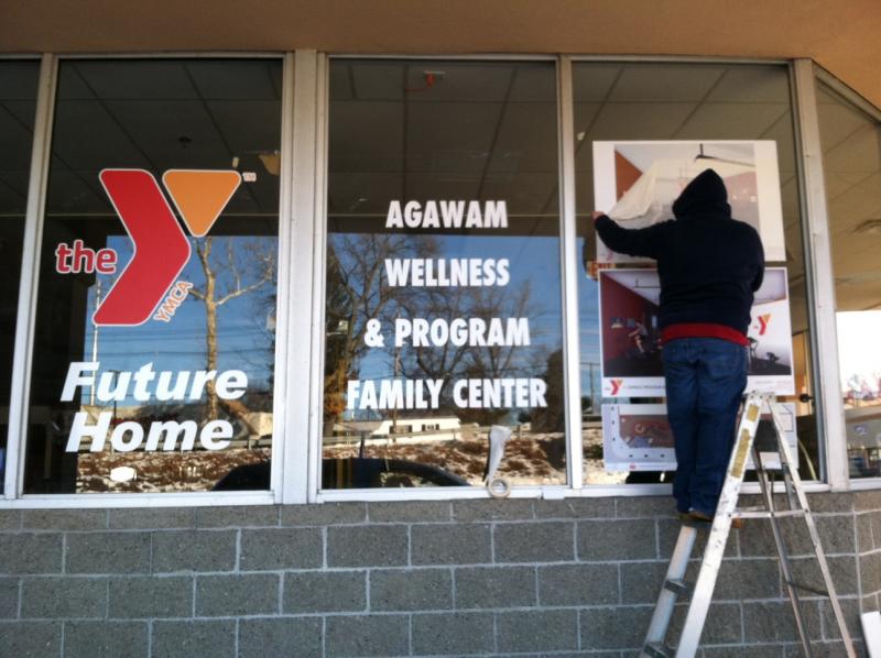

I had a similar question on the forum last week. We decided to dive in and just do it. It was around 28 degrees . We installed everything dry without a hitch.
