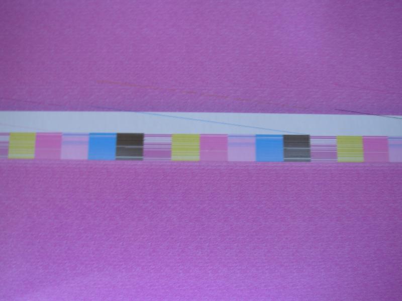

OK, lets see who will notice the problem with this test print first?
(and no, I'm not talking about the clogged nozzles)
This is a Mutoh Falcon Outdoor 46" 6 color printer.
:rolleyes:

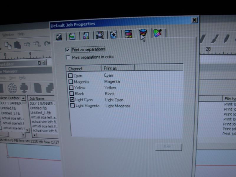

Thanks Bob, and basically I have cross contamination in Lc, so I was hoping to clear it by printing large areas of Lc only.
I took your advise and modified it one step further by disabling all colors except Lc in the Production manager and am now printing large blocks hoping to clear that line.
