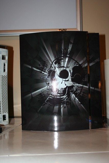

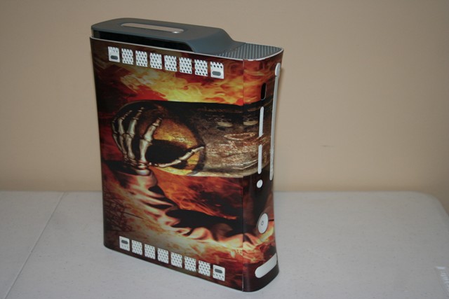

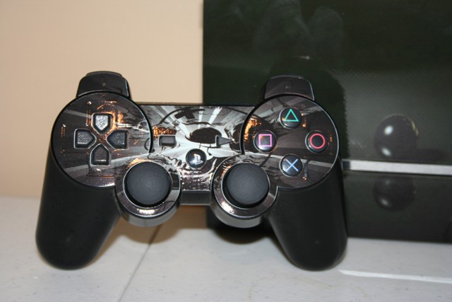

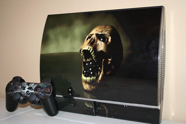

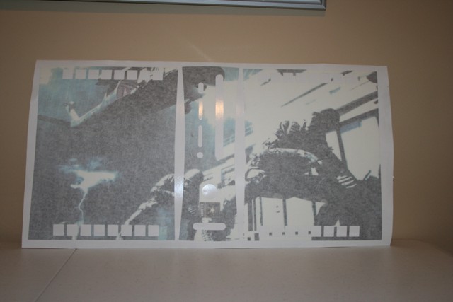

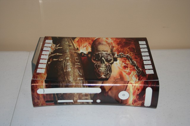

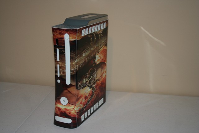

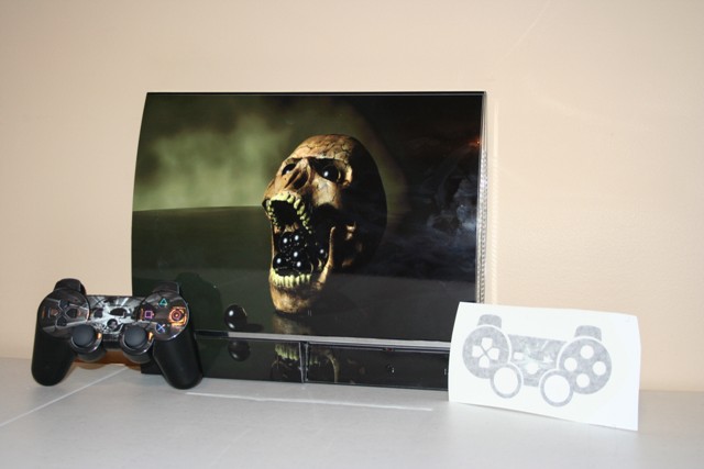

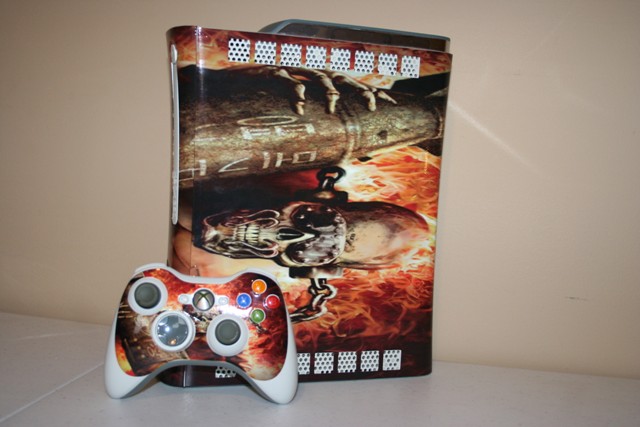

Hey guys we are doing PS3, Xbox 360, and Guitar Hero wraps around here like madding. We get around 30 bucks for the console and 20.00 for the controllers. 50.00 for 2 sq/f plus about 15 minutes of time. They sell like crazy around this area. Anyone else doing this custom stuff? I have templates for 360, PS3, Wii, Guitar Hero, and all the controllers. If anyone wants them I'd be glad to share them, they are setup to cut in versaworks already. We use 3M CTac with 3M overlam. I run them back through and cut then weed them and tape them, then I run them back through after taping and cut it again so you are just left with taped pieces of a puzzle pretty much. Makes it super easy for the enduser to put on. Thanks Guys.

Wow pm flood hahaha!! Here they are guys. They are in eps format. If you have any trouble with them let me know or if you want an ai or anything.
I don't want anything for them as some have asked, I may need a return favor someday and I am a fan of karma :)
I put them in a full package so the one zip file will get all of em for ya. The only thing that you have to trim is the 360 front faceplate. The holes for the memory cards are a little small. I made em that way as it seems to make lineup of the graphic a lot easier then just fold in it or shave it.

...We use 3M CTac with 3M overlam. I run them back through and cut then weed them and tape them, then I run them back through after taping and cut it again so you are just left with taped pieces of a puzzle pretty much. Makes it super easy for the enduser to put on...
Clever...never thought about running them thru after taping. Thanks again for sharing these!
KForceOH
Thanks for that one. I just came up with the idea when I first did a guitar. It was hard to get lined up just right without seeing the holes, so I sat there and cut them out with a xacto, then I was like wait there is a 20K machine that does this for me lets try that haha, so I really discovered this out of sheer laziness haha. But it works REALLY well then you just weed the tape out, and it makes the "stickers" very firm for installation.
