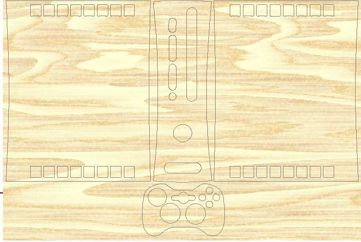

when you guys send this to the RIP, does it print like this or do you print it in masked mode? I'd think in masked mode it may go off track some, no?
