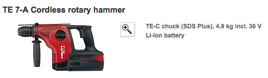

even used it to help do some work @ my buddy's bar. pop'd a series of 2" holes through 8" precast like butter. I think he's looking to buy one now too, just to have.
I also have the DeWalt cordless drill with hammer drilling option, but its just not the same. I feel like I'm burning out the drill everytime I try to use it for brick/concrete.

That Hilti looks SICK, but I'm not in the mindset of dropping $800+ on a drill set at this point. Any other recommendations that won't cost more than $300 or so?

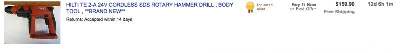

maybe surf ebay? there's older versions, still brand-new, in your price range. looks like you just gotta shop the batterypack/charger for it:
