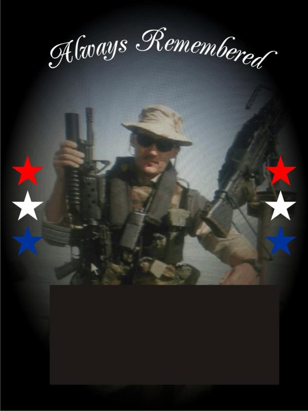

I have this picture that will be DTG printed on some shirts and would like to soften the edge so it is not so pronounced. Can anyone help me with this.

It looks like the image already has a soft border around it. Am I missing something?
EDIT:
Oh do you mean the gray box?
rcook99
Sorry for the explanation but I am trying to soften the outer edge so when it is printed onto the shirt it does not look like a patch.
rcook99
The drop shadow will not work. I would like to soften the outside edges to look similar to the inner edge of the black oval. Maybe I am missing something with it.

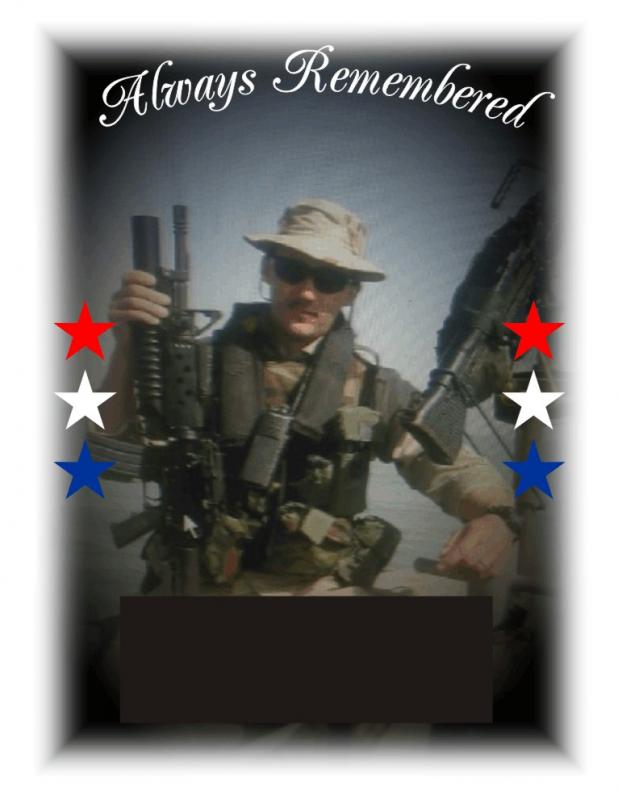

Your best result would probably be the masking tool in photo paint. adjust the feathering.It will take some playing around with to get the desired effect

Why don't you put the whole image on a black background, then use the interactive transparency tool to blend it out towards the bottom.

an alternative to blending it to the background is the Photo Edge F/X....it's under the Effects menu...
also makes it easier if you're doing a black or dark tee to manual mask the image to send a soft white mask layer

No big deal Joe I got it to work with the mask tool and edge feather tool in Paint.
