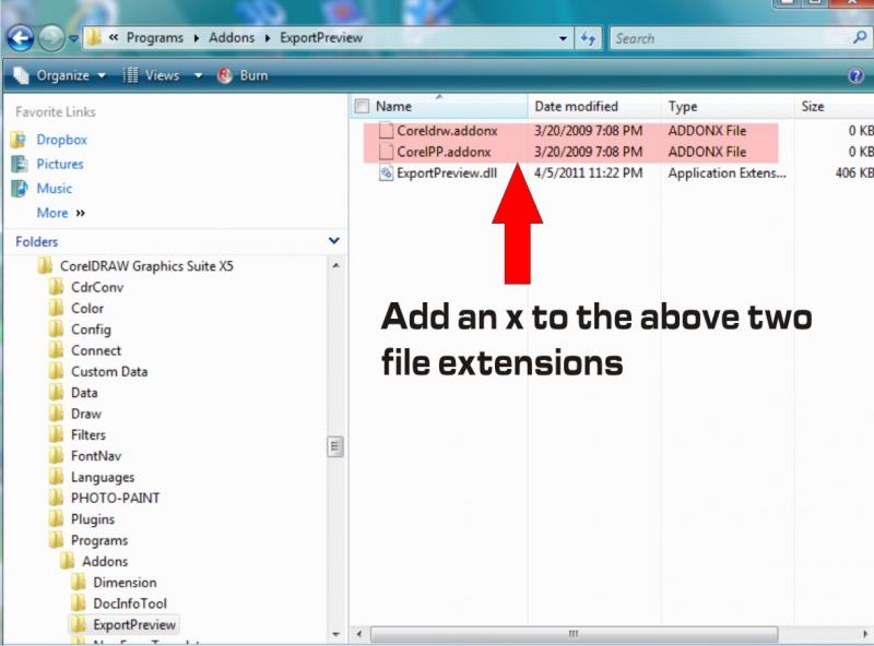

Hi all, new to this forum but a long time Corelian.
The Hotfix (to my knowledge) addressed 'some' issues with 'some' export issues on 'some' systems.
If you prefer to use the older style export dialog box in X5, you can easily do the following:
[1] Close Corel and navigate to the folder shown below
[2] Add an x to the 2 file extensions
The export dialog box should revert to what you've been used to in previous versions.
You can always change it back to the X5 way by renaming the extensions again and removing the x's
