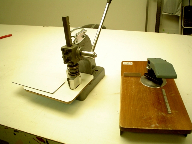

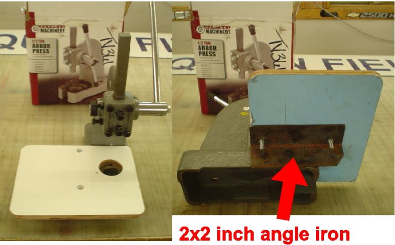

I built this one- this die is good for .063 alum- they had another one for thicker.
I posted it in the tips/tricks I think with more details. Gene
I was also thinking about just making my own with that harbor freight arbor. I might go and pick one up and make my own table for it. Glad someone else had my same thought. Thanks for the picture!
