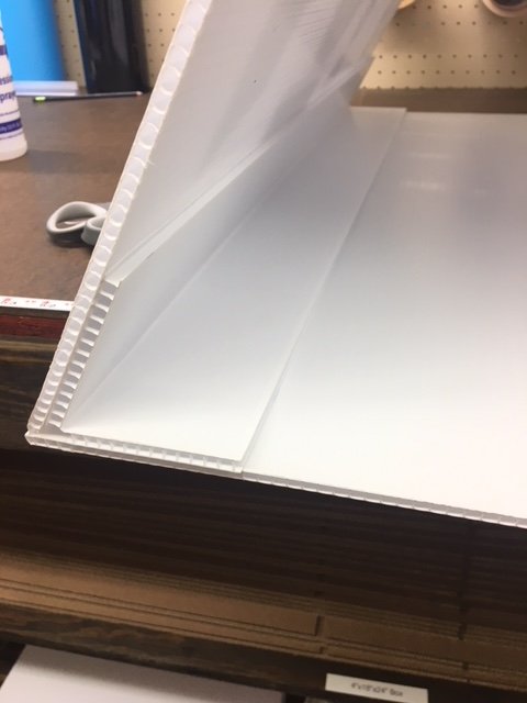

I have a 3 panel 6mm coroplast sign I'm putting together. Panels are 30" high x 24" wide. They will form a 3 sided sign so they need to be attached together on the 3 sides. So, I bought some plastic hinges, I have some that are 1" long and some that are 30" long. These things are a pain to get on! And I'm not sure they will stay together. Is there something else I can do? Thank you!

Okay, so cut some Cor-X 30" x 6", with the flutes running up and down. Cut along the inside of one side of a flute creating a hinge and load it up with double-sided tape. Apply it to the inside corner of two pieces and make sure it bonds perfectly straight. Now proceed and do the other two corners. It's gonna look wonky, but at least it will be functional.

Update! I used carpet tape and this damn thing is STURDY as heck! I'm glad my original plan didn't work...it's heavier, sturdier and not even the Rock will get these panels apart! I finished the edges off and it looks great! 6mm coroplast with all three corners reinforced with 6" of coro on the corners. It's battle ready. Thanks everyone for your help (Gino for the idea)! Reminder...order more carpet tape!
