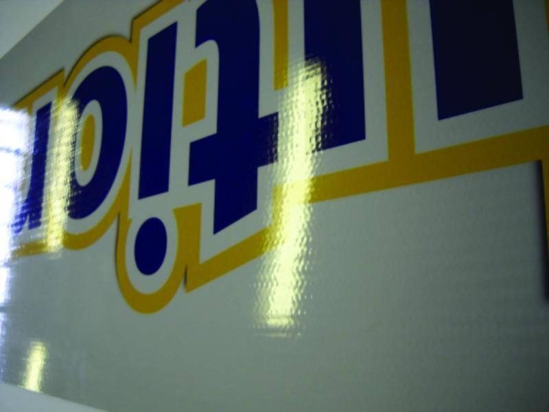

I ordered a few sheets for a client that wanted a lightweight temporary substrate without the flutes showing through.
it advertises a "Extremely smooth solid surface" however when i mounted a digital print onto it, this is the result
Is this standard with this material? does anyone have any experience with the stinger board?

I have had limited experience with it, but we printed directly on it, and did not apply vinyl.
It's odd your picture... its as though it crushed the honeycomb structure and showed the center...
How did you apply the vinyl?

i applied the vinyl with our laminator, but i didn't crush it, I can feel the slight texture in the board before I run it through the machine.
Correct me if I'm wrong, but with a 'Honeycomb' type product there are no flutes running the length or width of your material, but perpendicular to your face. This results in a very strong product for lotsa uses, but being smooth doesn't necessarily equate to seeing no indentations as we're used to seeing with Cor-X type products which are corrugated, and not honeycomb, like in the paper world of paper honeycomb products.
I'm probably wrong, but for $22 or whatever it costs, if it fits your/your customer's needs, then use it.... otherwise, I see no benefit or problem either way.

perhaps by using a matte lam, you would not see the honeycomb as much...I don't think its horrible regardless

thanks everyone, I don't think it's a bad product, in fact i'm pretty impressed with the strength of it, it can't be crushed by hand and it seems to take abuse better than coroplast does.
The issue i have is calling it an "extremely smooth surface", One would assume that to be on par with PVC or Aluminum or some other substrate we in the industry consider smooth,

It's strange... when I used it, I found it very smooth and didn't see any of the issues you pictured. Is it possible to have a bad sheet?
How does it look without the vinyl... is it smooth as expected?
No even without the vinyl you can see the wavy pattern in it, I called my supplier any they checked their stock, it's all like that, they did agree that it shouldn't be called a smooth product, hopefully they will change it on their website.

I have had the same experience, wasn't overly happy with textured surface. On some boards it is more noticeable than others. I think it might have something to do with how it's stored/handled. If you happen to press hard on it, the pattern is more apparent.
As for why not use PVC, yes PVC is nice and smooth but not stiff. This has stiffness in all directions.. similar to gatorboard/ultraboard.
