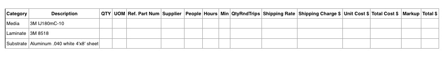

Always open for feedback!
Consider moving any label currently in a row up to become a column header. These are the attributes of data. Attributes only live as column headers, strictly speaking.
The attached image is just a rough arrangement as an example. Also, $ amounts are more focused along the right of the layout.
More to come.

Consider categorizing the long list of materials, services, and any sell-through products and treat them individually. Although, this example of three components may be sold as a single sign product with a name such as "Rigid Sign" for example, one can always track required components to cost-account accordingly.
