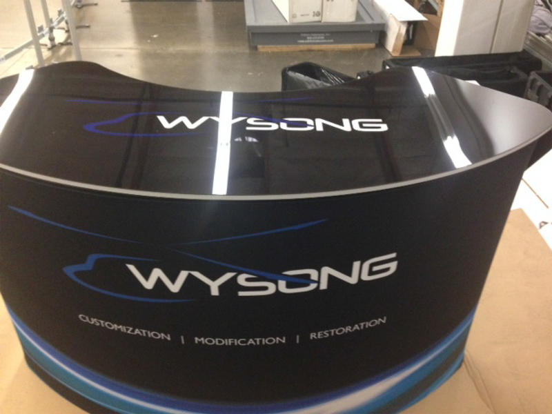

I like using a thick 25 mil matte polycarbonate laminate. It's bullet proof. Applying this over a printed wrap looks nice. The other option is the sandwich method which requires some pretty fancy tooling and expensive clear acrylic. Primary Color does this (see below). I don't know about Australia, but if you need to sub it, I might check with Selby's:
http://www.selbys.net/index.html
