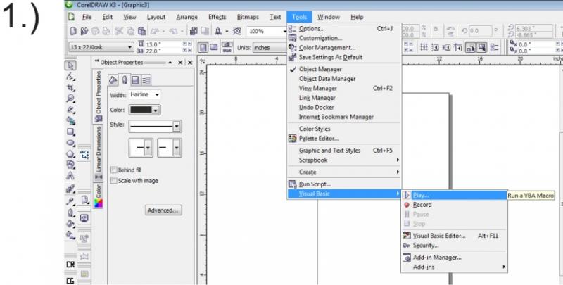

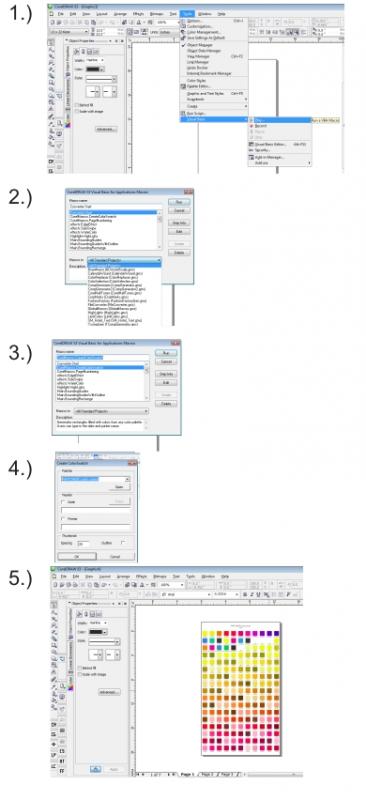

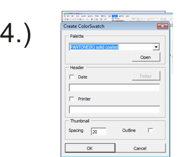

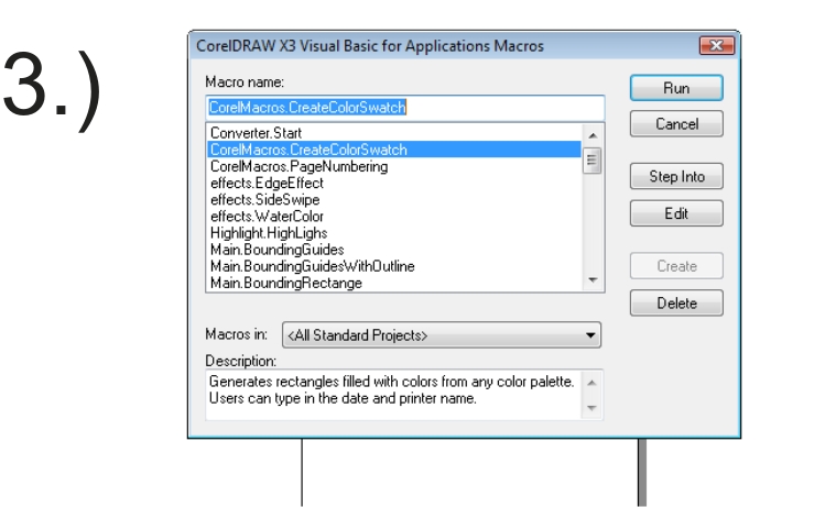

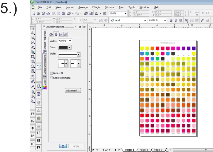

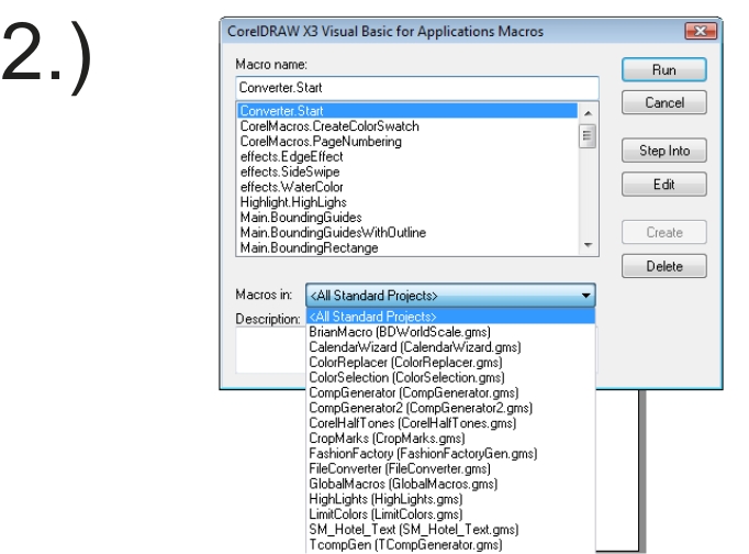

signage
Suz
Go to Tools>Visual Basic>Play
then go to the macro in dialog box and select (all standard projects) then select (CorelMacros CreateColorSwatch)> Run
Next pick which Palette {note in the thumbnail box smaller the number more swatches per page}>OK
It will create a new document with the swatches with several pages
See screen shots below

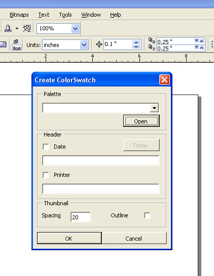

Signage,
Thank you for this tutuorial!!! I'm thinking there is something wrong with my program. I cannot do step 4 - that is where I got stuck before too.
I'm showing what I see in step 3, only because it looks different than yours.
In step 4, I have nothing that pops up for palettes. Is this where I'm losing it?
Help! Maybe I need to reload my software?
Thanks!
Sue

Suz, I have the same boxes with the same lists as you and works ok.
Tools > Visual Basic > Play > All Standard Projects > CorelMacros.CreateColourSwatch > Run Default CMYK palette > OK
If you change the Spacing # to a lower # you will have more colours per page.
