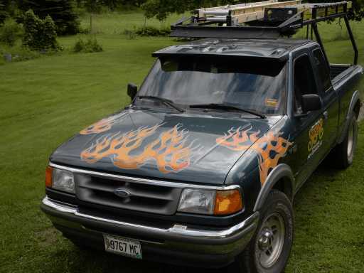

imaSIGNr
You can get some fairly nice flames by using cut ( yellow or orange ) vinyl and Krylon spray paint....
