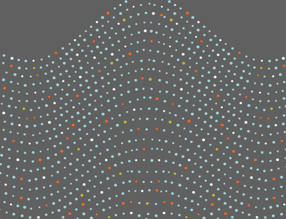

So one of our biggest clients has this dot pattern that gets put onto the windows at all their locations. Every dot gets cut out individually. One location can have 20+ feet of dots that go onto 8'-10' high windows. I'm trying to find a way to create weeding lines for this behemoth.
This is the current master cut file, just the dots:
This is an illustrator file that gets saved as a PDF, ripped through Onyx Thrive 22, printed on an Epson S80600, and cut on a Graphtec FC9000-160. I'm open to any and all suggestions that don't involve creating lines one-by-one for thousands of dots...

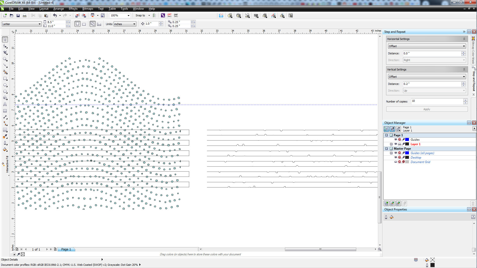

The problem is the dots aren't uniform in the least for vertical weed lines. These programs won't create irregular lines around objects, just straight ones.
So options are to print and plot and then hand place all the weedlines with your knife in hand, or sit in your comfy chair and draw a few dozen lines for the plotter to run. Looks simple enough for the bezier tool...
Or you could add outside contours until they start to overlap, which causes them to weld together, hopefully they are spaced apart vertically different than horizontally, so they weld together at different degrees, allowing you to stop adding an offset when one run welds together, break it apart, and use that wavy line for the weed line.
Or just draw vertical lines, then use the trim feature to generate an outline. Of course! It won't give you pretty weed lines, and it will double cut some areas, but it will give you 1" (or whatever) strips that you only have to worry about the dots within that region, definitely better than nothing.
Reactions: 1 users
taggianto

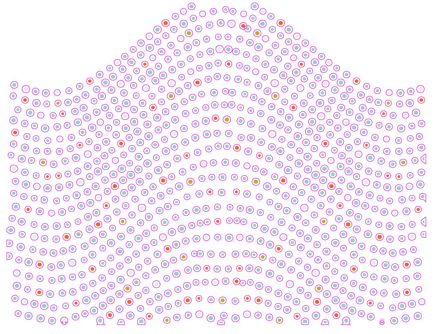

I think what I would do is weeding circles. Select all the circles, offset path some. Now you have a circle around each circle.
Pull away the bulk fast when weeding and then weed out each individual circle. Should go pretty fast weeding that way and minimal chance of losing any circles
I thought about this but it kinda doubles the number of parts to weed around. Yours traced out much smoother than mine.
